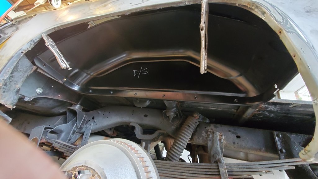

I used new wheel tubs for the pickup on my 1990 v2500 burb they are just slightly longer and shaped slightly different towards the rear.
I made them fit nice
with a little work.

That's awesome! How was attaching the new tubs to the rear quarter skins? Any major or minor problems along the way to look out for? Still haven't been out to the shop to get pictures for everyone, but I will here in the next few days. Your finished product is amazing!

They fit to the inside of the panel great. And met up against the floor pan no problem. The toughest part for me was inside towards the back spare tire well,mine was nonexistent so I had to get a little creative.
Hopefully your rust won't be as bad. I sectioned a third tub for the spare tire well.
I tried to keep the factory contours as much as possible. These pics where the test fitting phase.
31,889
32,682
