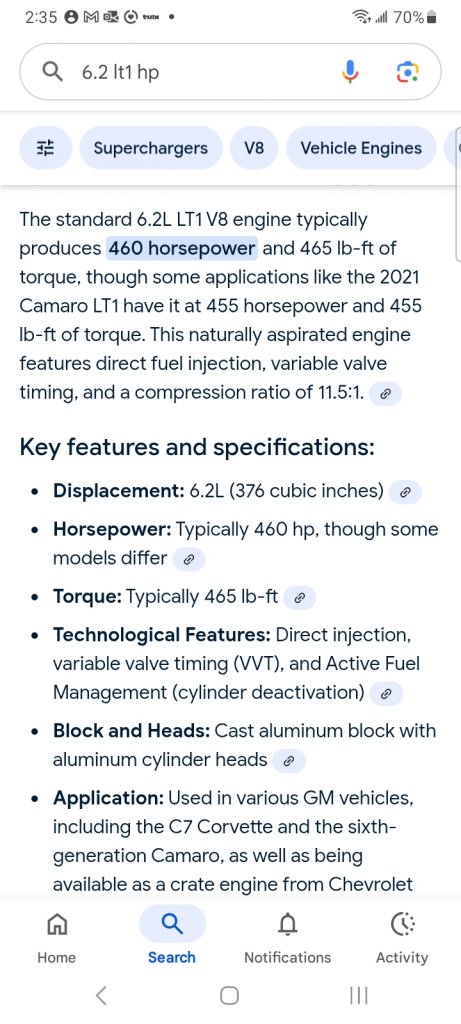

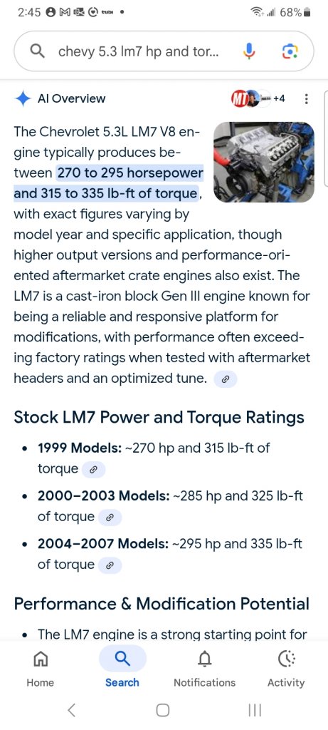

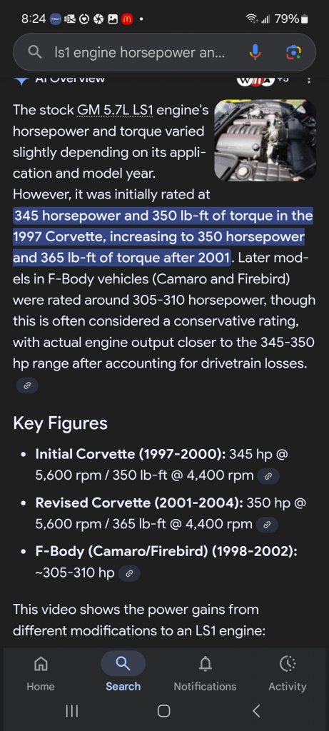

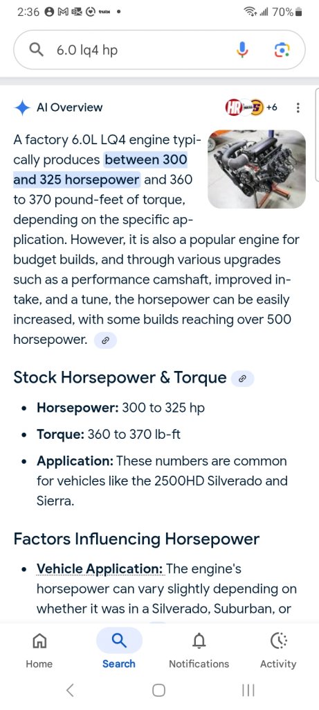

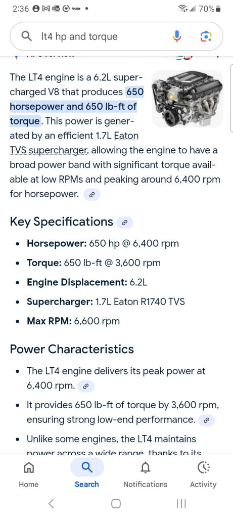

New to form and just picked up a 1984 c-10 with a 305 and would like to know if I would be better off putting in a 454 or LS for resale value .
10,175
19,682
Lt will have better resale,more power,more modern,efficient, etc. Lt swap kits are out there and will get more common as time goes on.
