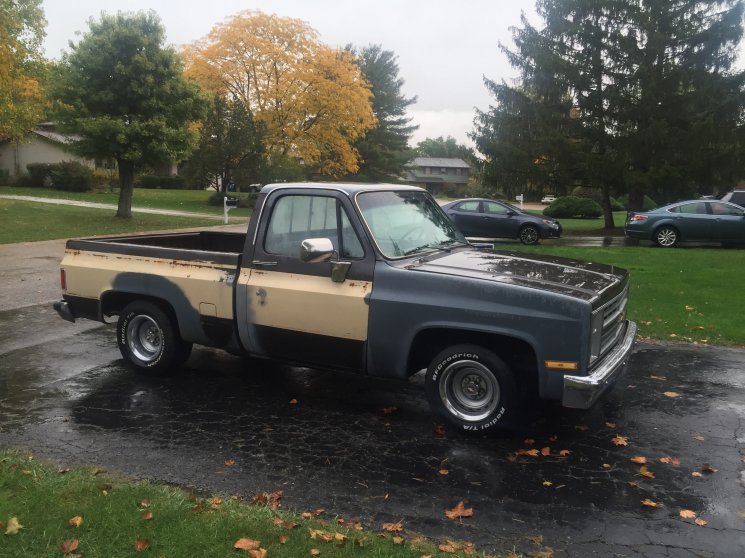

86 C10 Shortbed
Jul 19, 2016
165
170
Ohio
Mark
5.3L
I purchased the Magaughys 2.5" front/4" rear drop kit. They have two different versions depending on how thick your front rotors are. 1" thick for light duty brakes and 1.25" for heavy duty brakes. I ran my 15" ralleys with 275/60/15 with no rub in the rear. You will also need to notch your bed rail to clear the rear shackles. I also installed polygraphite bushings front and rear. The ride is smooth and tight.
Mark, did you install drop spindles in front or just the springs?
