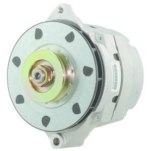

Rock Auto has some brand new (not reman) 78 amp ACDELCO's for a real good price - $73 with no core
ACDELCO Part # 3351094 {#88877304} NEW UNIT
GENERATOR WITH A/C; REGULAR CAB; 4 WHEEL DRIVE; DELCO-12SI 78AMP
GENERATOR WITH A/C; CREW CAB; 4 WHEEL DRIVE; DELCO-12SI 78AMP
If I needed an alternator, I would be all over that.
When you buy an internet alternator be sure it got the correct style pulley for your belt. But it's not a deal breaker if the style is wrong - just re-use your current pulley.

Thanks! Probably a stupid question, but would that alt be ok to use in a non ac truck? and I have a serpentine belt, is it hard to switch the pulley without marring it?
Thanks again

Oh yeah, it will be fine. It just has the capability to provide a bit more power if the truck has certain accessories.
Some accessories - like an oversized blower (as in an A/C truck), a massive sound system, a winch, etc - can create a significant drain on the electrical system.
An oversized alternator can meet the demand created by those add-ons during periods of peak loads.
But if the truck has no extra electrical components - like yours - a higher rated alternator just lives an easy life. Matter of fact, due to lower operating temps and the use of heavy duty components, it will most likely last much longer than a standard unit.
