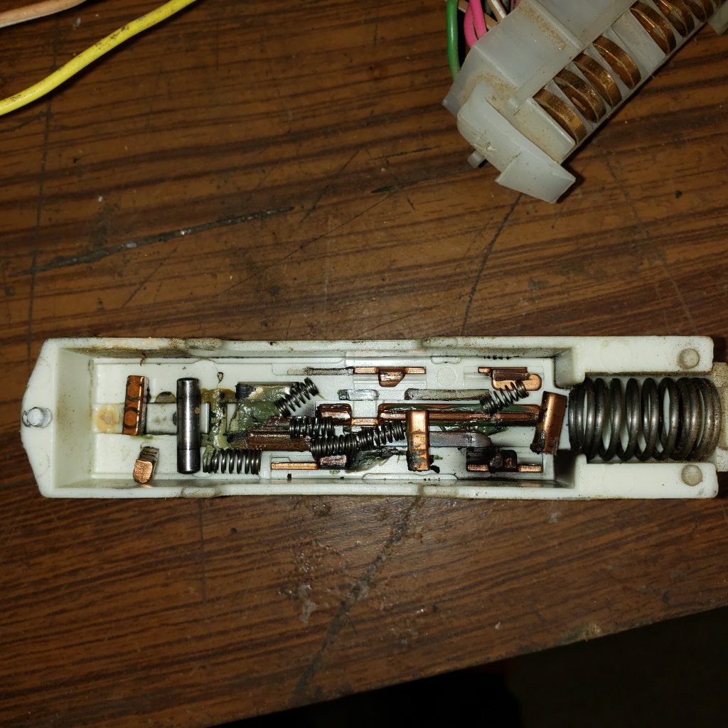

If I remember correctly the 12 volts does come from the ignition switch unfused. Kinda like the coil does on a 5.7 tbi. I had problems with not getting a clean 12 volts to my coil and it was the ignition switch.
This is a ignition switch pulled apart. Pretty bad inside of there and burnt and corrosion. Cleaned it up and alot of my problems went away.
