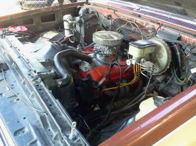

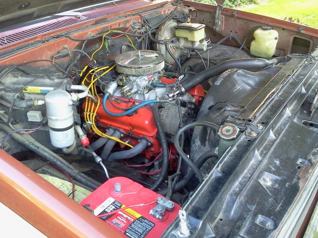

For awhile I have been thinking of swapping in a 6.2 diesel into my truck. Right now it has a 305 in it with a 700R4 transmission. 2wd 1/2 ton. What would I have to do to get it in and would the fame handle it? I've been told that a 6.2 is about 800 lbs. I do know that I would need a diesel tank and lines plus the fuel pump and injector pump. Can I use the motor mounts I have already? Wiring is another issued I'm not quite sure of. I know this sounds bad coming from a diesel technician but I am just starting. These pictures are of what it looks like now. Can I use my current battery too or would I have to get another one? I would hate too mess with two Optima red tops lol. :headbang:

6.2's have a lift pump mounted to the block like your small block. See no reason why you can't use your existing fuel tank/s and fuel lines. Clean them out and hook up the fuel pump. Engine mounts are the same. Will need a bigger radiator. Need a filter mounted between the lift pump and injection pump. As for wiring take the existing hot wire to the dist and run it to the injection pump. All other wiring should hook up to alt etc. Should be a pretty simple swap. Front springs may need to be replaced but I see no reason that the frame would need anything.
