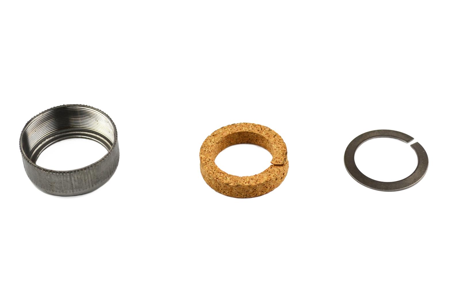

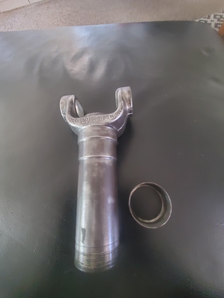

After talking with Dana aftermarket on the phone I think we may have found the right one.. after lots of looking. Part# 3-16-31.. can't find it anywhere for sale online or in store. Not at napa o riliers or autozone. there's gotta be something out there that will fit it. Got directed to a couple driveline shops near me that stock spicer. Well see if they got something for meYou'll have to get measurements for your application, but this is what you need.

Looks like that but I believe the one that came out was splined.You'll have to get measurements for your application, but this is what you need.

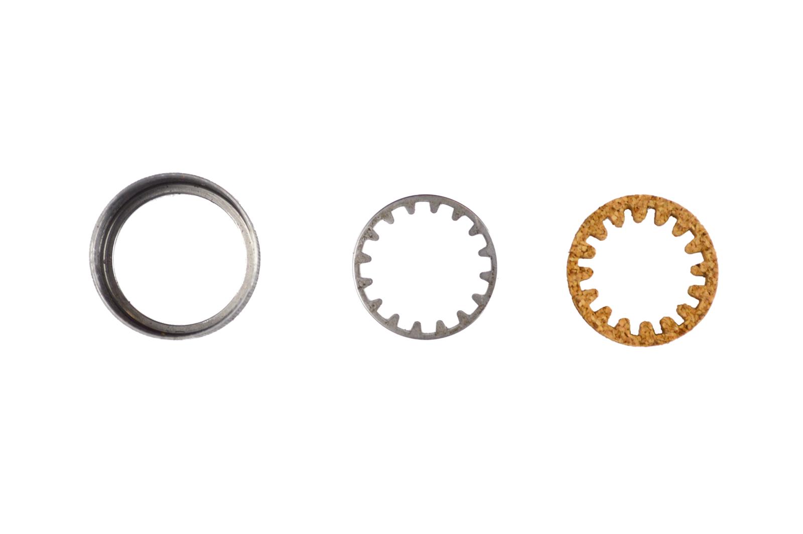

Hm. Looks close, but there is no dimensions in the description and or mention of yoke that it fits.It's not that hard to search. 1 minute searches..

So the one prairiedrifter linked you to a week ago? I searched on amazon when I needed one. It popped up as the right one for my 1980 K25 and they have them next day prime shipping from the spicer store.Okay, found out its a 1350 yoke and got the seal I needed. Dana Spicer part #D3A
Close to that but not splined. I thought it was splined but guess not. Just couldn't find out what my yoke was specifically and the right seal for it. Don't really trust the automatic fits your vehicle stuff on old vehicles I don't know about. Never know if stuffs been changed or modified.. atleast I don't because... new at this. Good to know they're on amazon but found a knowledgeable driveline shop because of this, so it was worth it.So the one prairiedrifter linked you to a week ago? I searched on amazon when I needed one. It popped up as the right one for my 1980 K25 and they have them next day prime shipping from the spicer store.
https://www.amazon.com/dp/B00GAPISNU/
The one he linked you to in post #5 was in fact the D3A non-splined one that is correct for the K20 front drivelines.Close to that but not splined. I thought it was splined but guess not. Just couldn't find out what my yoke was specifically and the right seal for it. Don't really trust the automatic fits your vehicle stuff on old vehicles I don't know about. Never know if stuffs been changed or modified.. atleast I don't because... new at this. Good to know they're on amazon but found a knowledgeable driveline shop because of this, so it was worth it.
Post #5? Appears to be splined if you open the link. You may have meant post#2 but that seal in post #2 is also the incorrect seal for my aplication. Either way, the post was unable to confirm specifically that it was what I needed. Thanks for your inputThe one he linked you to in post #5 was in fact the D3A non-splined one that is correct for the K20 front drivelines.
