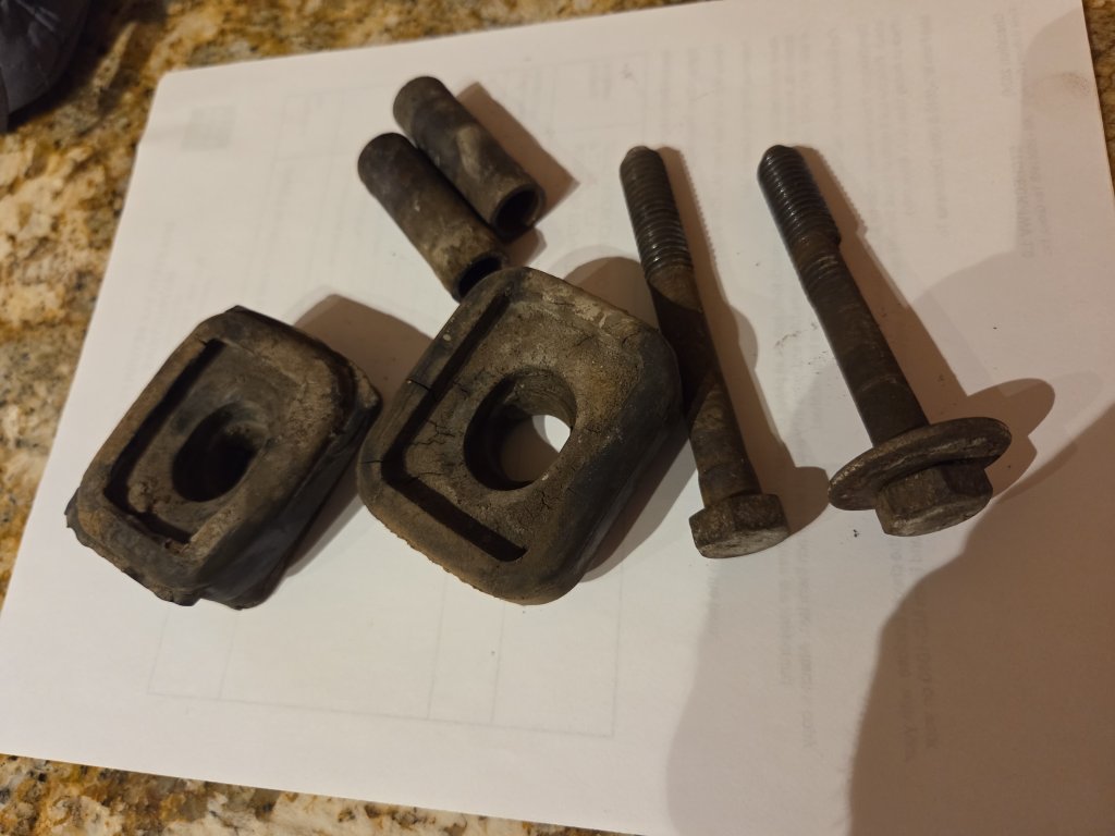

Does anyone know part numbers and/or where I can find the mounting hardware for an NP205 on my '78 K10?
I'm not seeing anything applicable. Mine mount to the bottom of the case through a crossmember (not side mount).

Reuse the bolts.
The bushings are available from many vendors in both rubber and urethane, match the material to the motor mounts.
