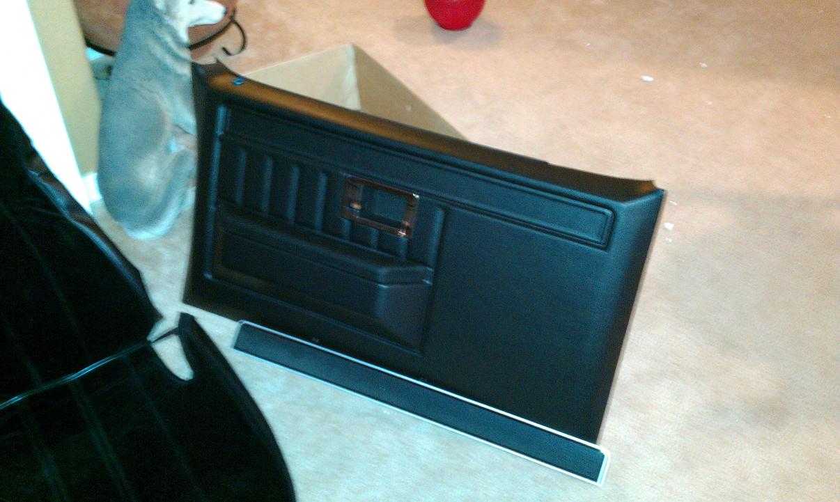

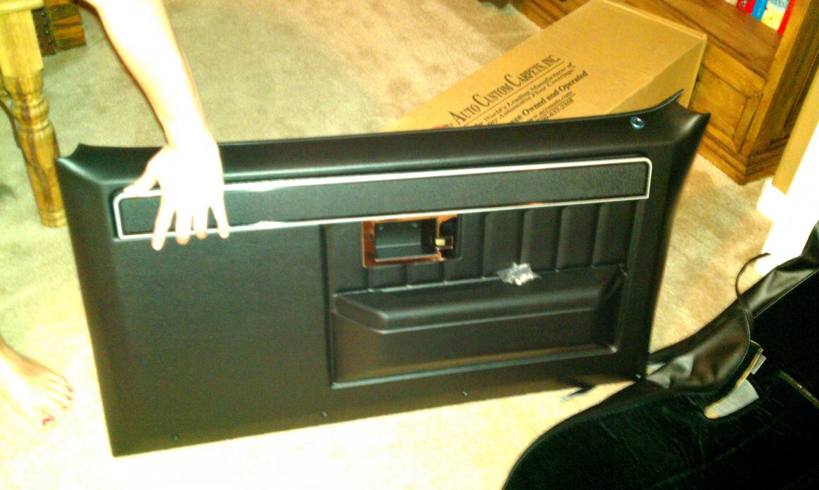

I got some LMC door panels in my truck and yes you do have to cut out the holes for the window crank/window switches, door lock switches, upper door trim and handle bezel but its all marked on the back side. Here is a little tip, add some rivits to the felt strip they dont put enough on them.

I didn't have to cut any holes?? :think:

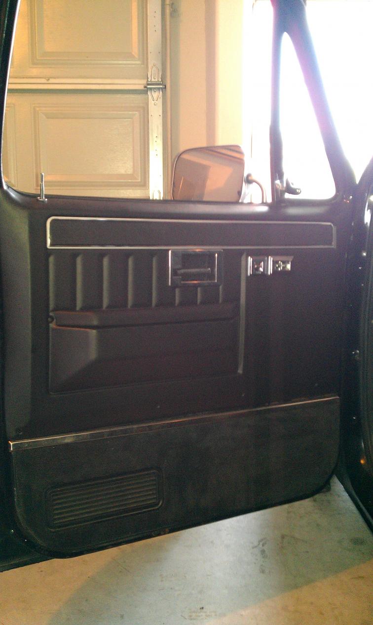

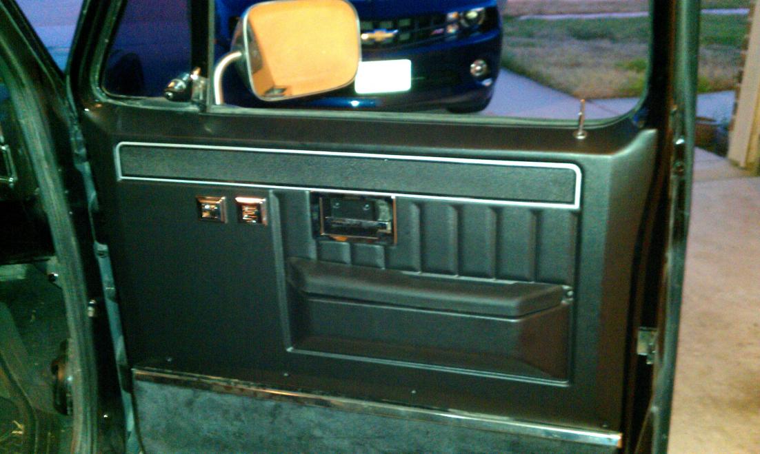

This is how you get them. The handle bezel and arm rest I just set in there for pic

Is that a factory trim piece?

Its a repop from classic parts. My truck is a silverado but I dont like the big silverado trim so I changed it to the base model trim (scottsdale/custom deluxe/sierra)

Ok, cool. I guess I meant to ask is it a factory style piece. I noticed LMC sells trim that's made just for their door panels, but you can only get it with holes for the door pulls.

The piece I have is an exact replica of a factory style trim piece. LMC does sell the silverado trim with or without the door pull handle holes. LMC also sells an aftermarket style trim piece that is not like the factory pieces, that vmust be the one you are refering to.

The factory style trim pieces WILL fit these door panels, you just cant use the carpet inlay on these and the aftermarket trim doesnt fit stock door panels.
