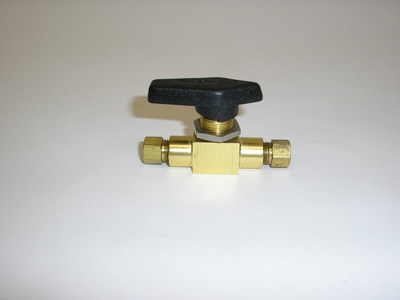

Anybody tried something like this? It's a parking brake valve, typically used for Kit cars. Hold the brakes, turn the handle, and it keeps pressure applied. Do this for at least the front brakes would either require some "creative" plumbing or some kind of remote handle, but it would provide protection from drive off and haul off situations, albeit not complete protection. At least if they hook up to it and start pulling, the tire screeching will notify you of an issue and keep it from going too far before it catches too much attention.

I'd think long term application of pressure to the brake components (especially on old vehicles, if not all new brake components) would not be a good thing for the caliper or wheel cylinder seals.
Aside from having to either run brake lines into the cab or be a 2 person operation.

Many years ago when I had a 65 C20 it had one of those valves. It was a single cylinder master, so the one valve held all 4 brakes. Issues,
#1. Had to route the brake line into the cab to the valve and then back out.
#2. It would leak down over time sometimes. Even the teeny tiniest seep at a wheel cylinder that normally wouldn't even leak with normal braking would leak the pressure off overnight.
It was really great for I need to park on a steep hill for a few minutes, or long enough to hold the truck to put a block under the wheels. I didn't use it for this, but my friend would drive it now and then and he'd use it like a hill holder releasing the clutch. It had it's uses and was handy but I'd never take the time to install another one. JMO of course.
