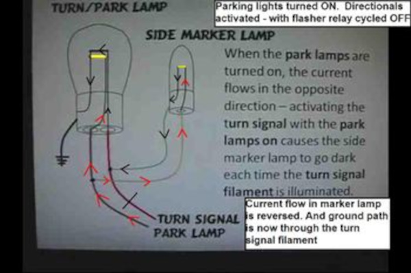

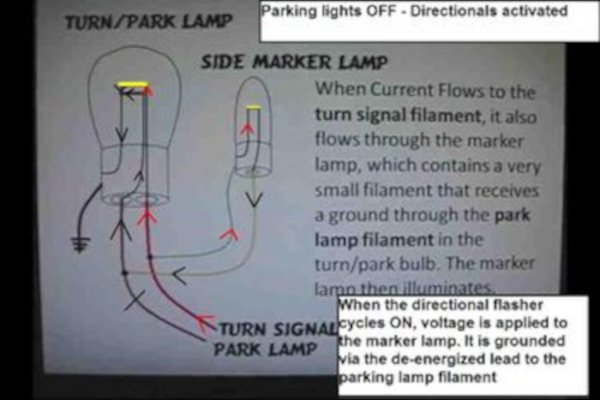

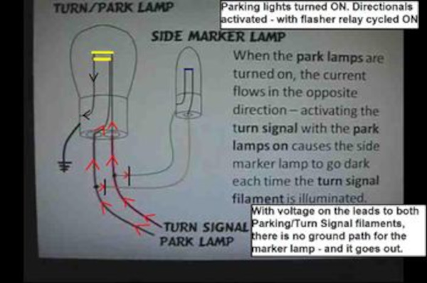

Found these and thought they were excellent showing how the front park/dir lamp works with the side marker lamp.
Side marker lamps have current coming from different directions depending if lights are on or not.
LEDS (light emitting diodes) only allow current in one direction- unless modified somehow.
Front park/dir lamps have dual filament bulbs. The side marker lamp uses one of the filaments to go to ground and which filament it uses depends if the lights are on or not.
