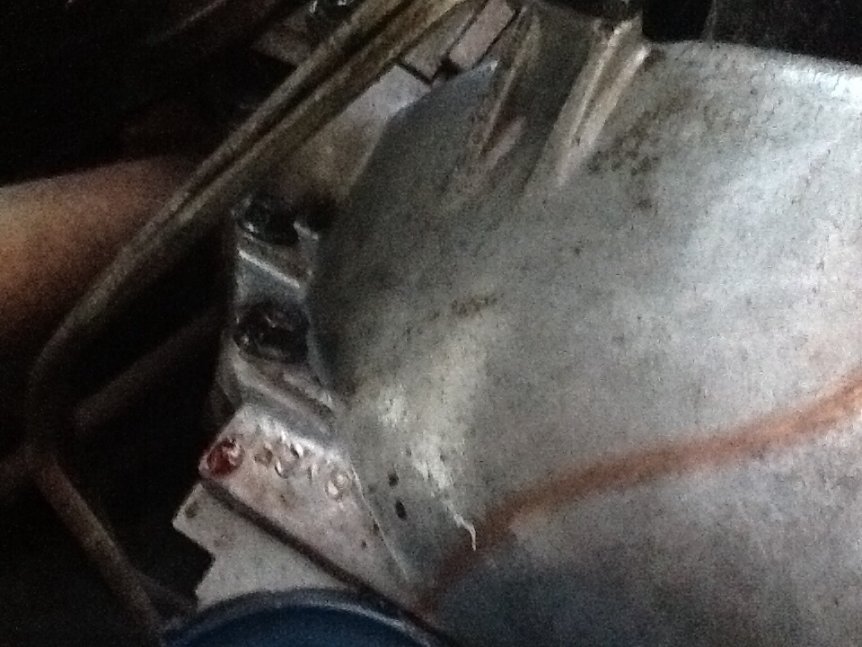

1986 k3500 is leaking bad. It has finally warmed up and I rolled under to have a look. I thought letting it sit out the cold was the humane thing to do as well, it would concentrate the drip of trans fluid and help pinpoint the leak. I am still not clear on the source. Anyone point me in a general direction with these pics?

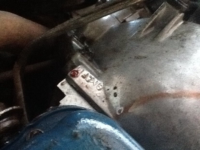

Pic2
Pic2

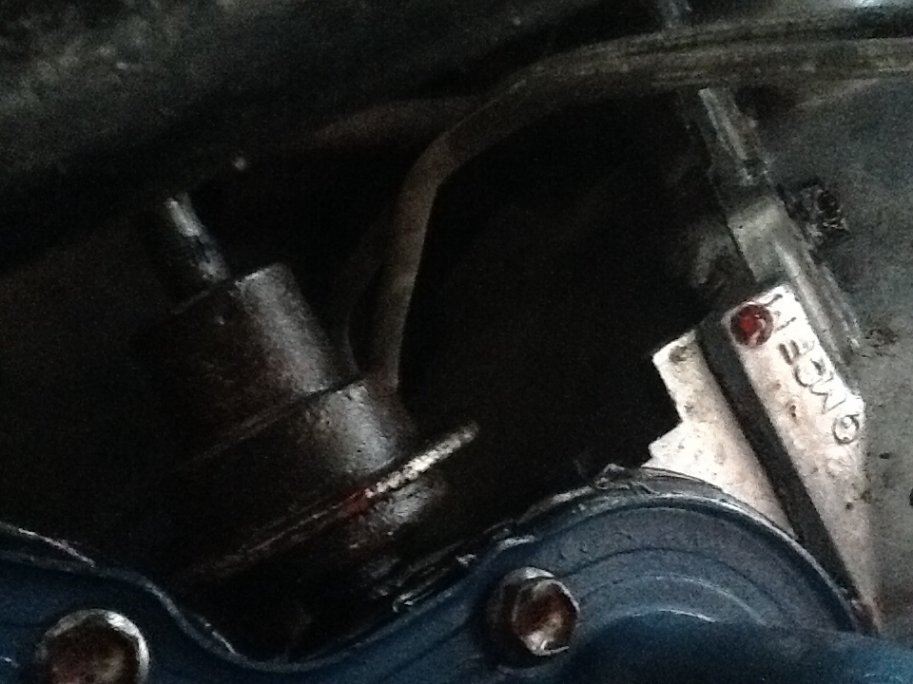

Parked for 2 months at least and the leak is not stoping if that helps in diagnosis.

Either vac modulator or cooler lines I'd say.

Thanks Fire. I plan on rolling up on some ramps to get a better look. I'll start there.
Maybe some better , not a lot of room atm.
