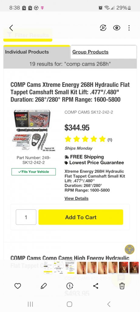

IMHO I'd run a Comp 268h it has an operating range that comes in a bunch lower which is where you really need it without trading much off the top. It's what I'm putting in mine.

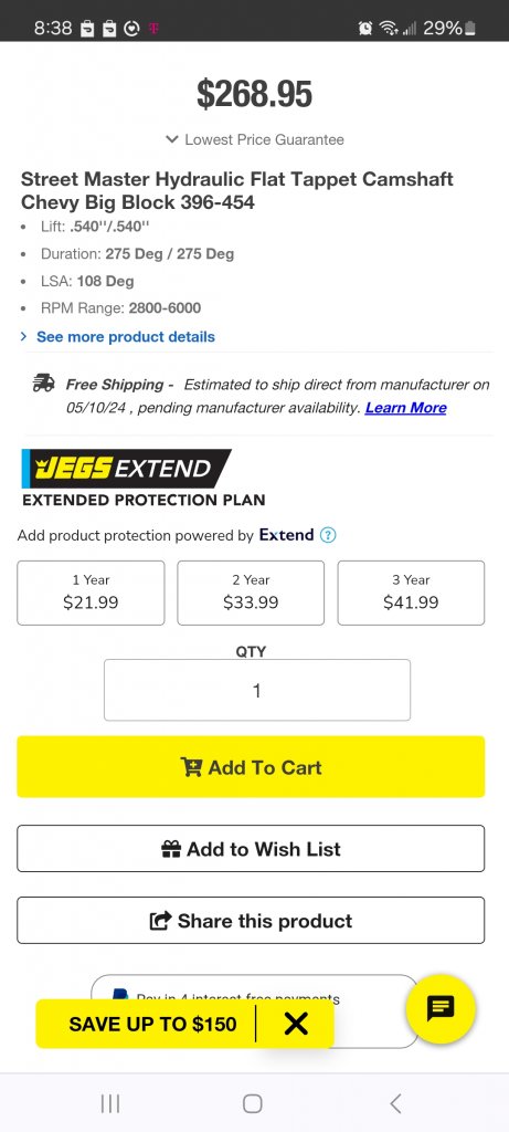

Looking what I found, this would be greatvtruck motor imho

I run a Comp Cams 268H in a 408 and it is completely adequate (for a daily driven street truck) under a Holley 670SA.
