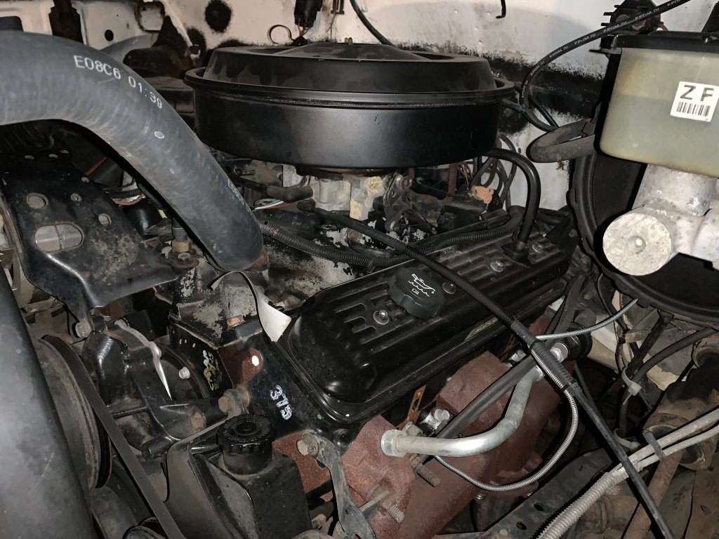

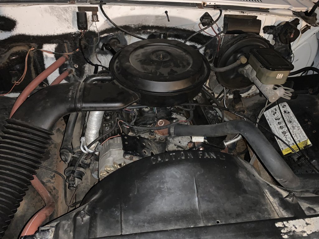

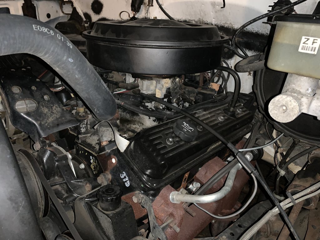

I will get some better pics today. Would the dealer who installed it he motor still have any paperwork? It should still be under warranty through this year? I agree that I will not be doing anything until I know what I have. I am just going off what the guy told me (290hp). He wouldn’t lie to me intentionally, said he had 3 power options when he got the motor (maybe 220ish, 265, and 290). Maybe he is mistaken.

Looks like I have a direct factory replacement 350 crate motor. Part number is 12568758. Specs I see so far online is that this thing is about 2/3 the horsepower I was told it had lol.
That being said:
What are some good options for intake manifolds/ heads / throttle body, etc to get the most out of this thing without digging into drivetrain?
Other modifications to this truck will be long tube headers with 2.5" or 3" duel thrush rattlers with no cats and 35 or 37" tires. Everything else will be cosmetic (paint / badges / seals)
Any suggestions or feedback is greatly appreciated. This truck is 2 months older than me and I have had it 2 weeks. I am completely green other than the reading I have done on this forum the past few weeks.
Thanks again everyone

TBI is great for drivability and mileage. Tunability is not a strong point of the system though. You need to do some research and decide what your use case is going to be, and then make sure you select components that will match what you want. The stock TBI can be made to work up to about 400hp without too terribly much modification, but you would need to select a bunch of parts that work well together and then specific modifications to the TBI system followed by a good tuned PROM chip. The easiest solution(but definitely not cheapest) would probably be to get a good towing/RV cam, new summit vortec heads(they will match the stock swirl port chamber volume but greatly improve combustion efficiency and flow), and an edelbrock Pro-flow 4 EFI system. You'll need to replace your TBI in-tank fuel pump with an EP-381 to support the higher fuel pressure needed by the MPFI system.
Looking at the specs on that crate motor... it is a california smog legal engine and is absolutely hog tied by the cam. Going to a decent cam will make a huge difference on that motor. I would bet you pick up a bunch of power just from a good cam choice, some long tube headers, and a PROM flash

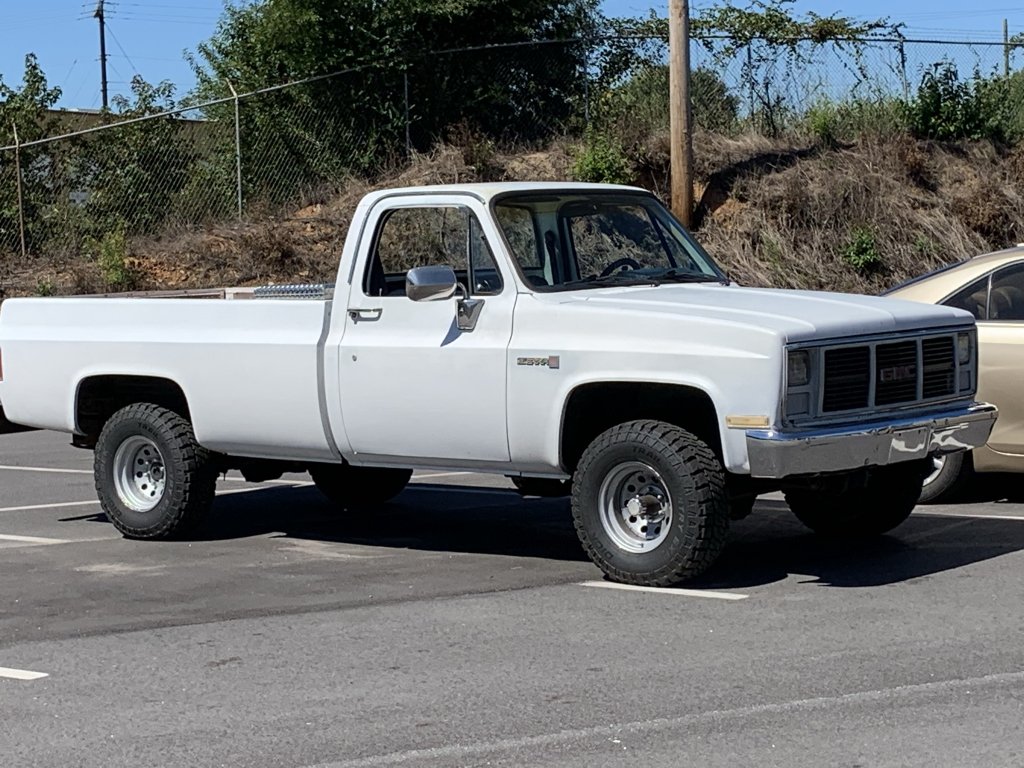

I am going to do a little more digging, I will post progress pics as I go. Here she is at beginning phase (at least from me)
