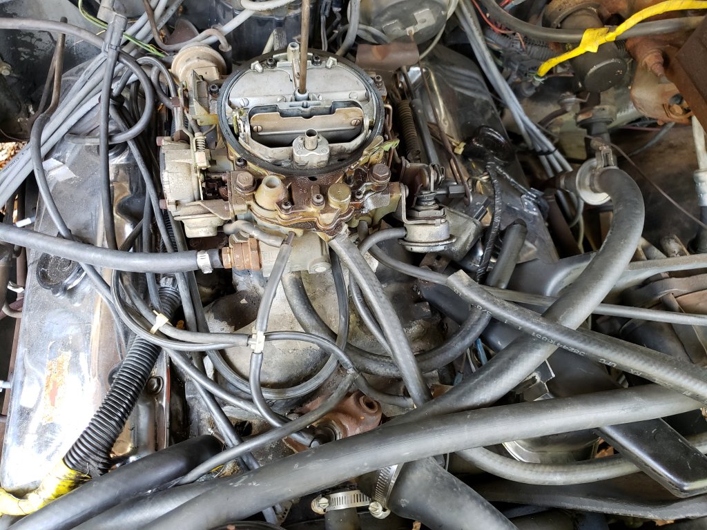

Crap look at all that **** on top of that engine!

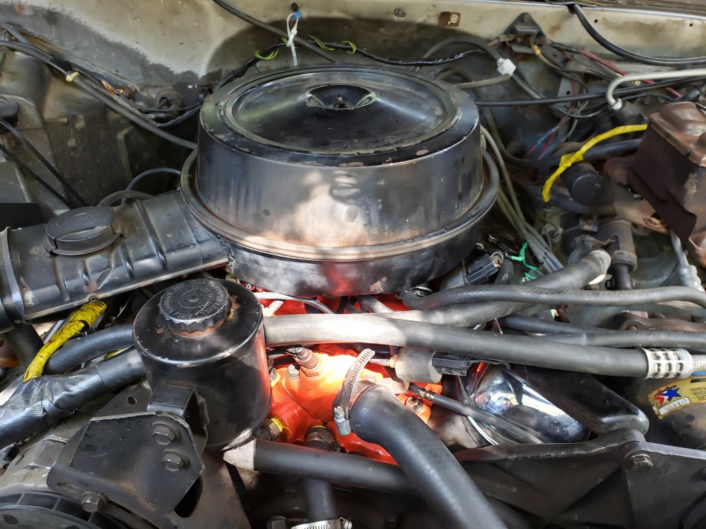

Yeah, Chevy cornered the market on rubber tubing this year. Gonna pop a valve cover tomorrow to see what heads I have. Hopefully I can get an intake, the one that's on it currently is just cold patched. I've memorized all the lines so I don't have to mark them. (Yeah Sure!)

Here is a current pic of it. Like I said earlier, it’s been off for a year now so it has some rust and will need to be cleaned up. The front water pump bypass fitting still needs to be removed. Otherwise it’s good. You can have it if you want to pay the shipping.
dsteelejr, I checked the head casting numbers and they are peanut. This manifold will fit and all fittings match what I need. If your offer still stands let me know what you need in order to ship it. REALLY appreciate it!
