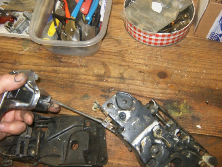

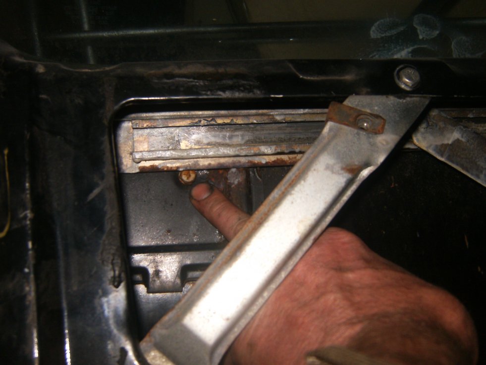

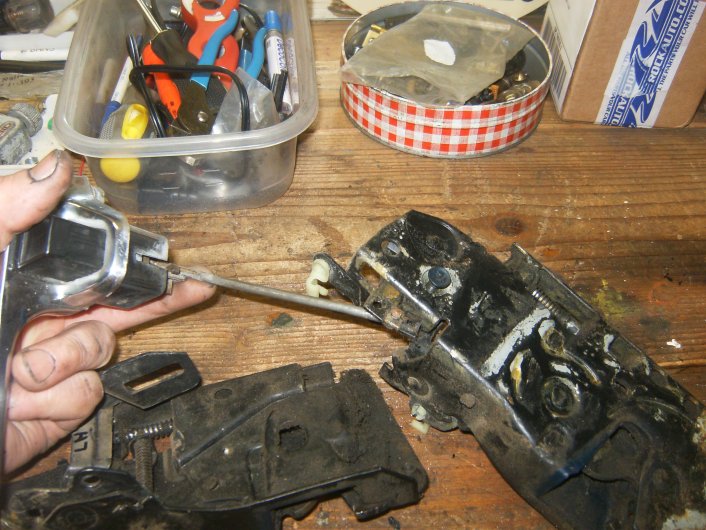

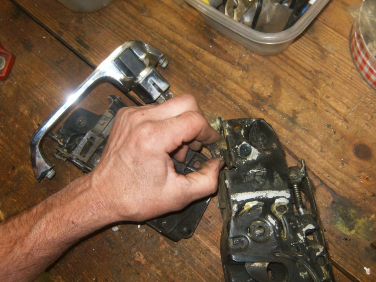

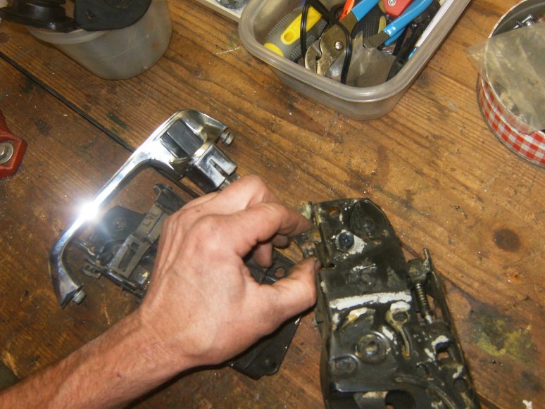

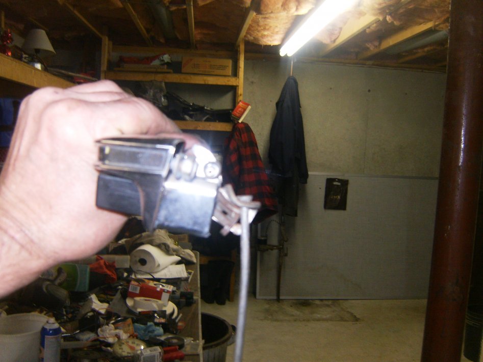

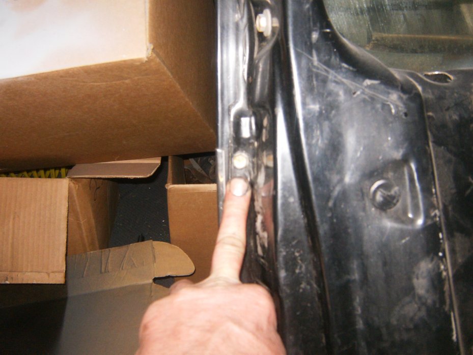

Need some pointers on installing exterior door handles. Just painted my truck and dont remember how I took off the damn handles.

Some images and a brief instructional - the little metal locking clips can suck to install and remove when everyting is inside the door :

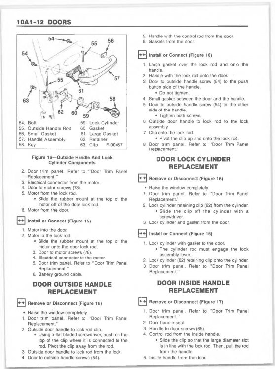

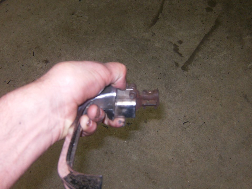

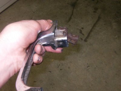

4 more and a procedure
The quick silver fox jumped over the lazy brown dog - they require a message to post to a thread - no images alone.

Thank you very much! That helped out a bunch!
