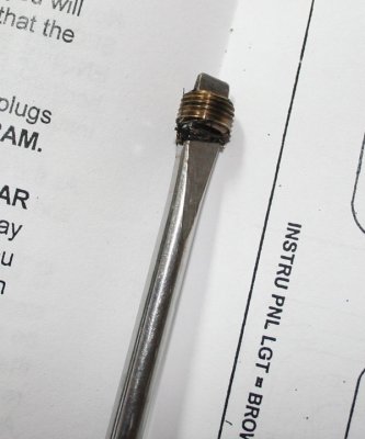

Got it out!
Using my trusty rubber gripped Klien brass tubing extractor... Tapped it in there with a pair of side cutters and then carefully put some force to turn it, and then.... and then... and then...
IT BROKE FREE!!!
:big_banana_Dance:
attachment.php
Now all I gotta do is find a replacement..
Pretty sure I have a 1/8" nipple in stainless or gal, but I should probably put something like brass back in there, in case I screw up again... Maybe I can find a die for it in one of my tap and die sets... The original nipple still has a few threads left on it, so wouldn't require much!
Boy that kinda put a damper in my plans for the day... But I'll take it.. At least I can move forward again..
Thanks!
:signs1:
