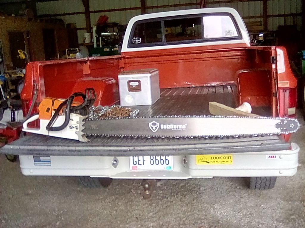

this is my 2nd biggest saw. I'm only 61, maybe when I get older I'll downsize...lol
