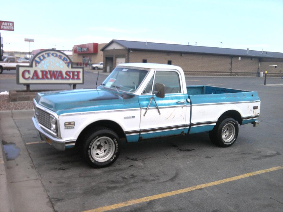

look at some original patina rides for ideas
this is my original paint 71 c10 its patina is awesome but this pic does not show it very good
