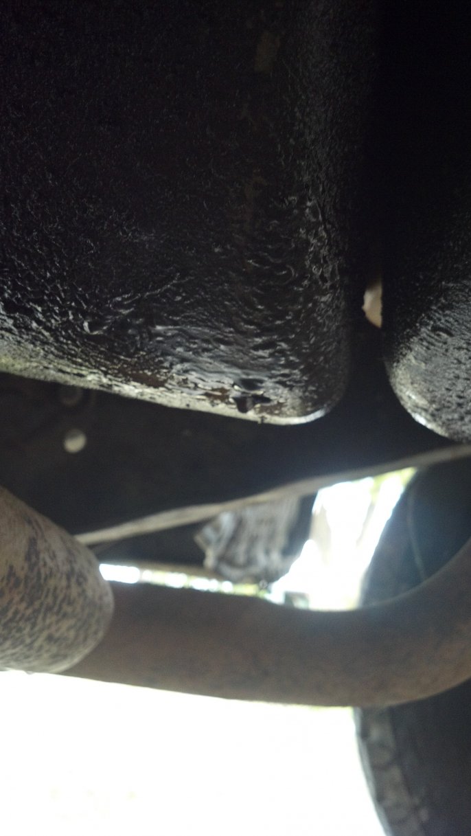

I took the dogs for a ride to our favorite spot for them to get out and run. I stopped at a store to get some beverages and I smelled fresh oil coming from my truck. No smoke so it isn't coming from the valve covers onto the exhaust manifolds. And nothing from the sides or the front of the block.
I only saw a small spot under the truck. Keeping an eye on the oil pressure, it started out at 40 psi going to the spot to run them. Coming back it ran at 20 psi and would sometimes go up to 30 psi. But the smell of oil was definitely noticeable coming through the vent. I got home and checked the oil, it was full, but there is definitely a leak, and I think it is the rear main. Looking at the attached picture, what do you guys think? I figured with the top end being all new, and the truck sitting for so long without being driven most of its life, that the bottom end seals and gaskets being old and brittle cannot hold up to the pressures being generated from a fresh top end. Does that make sense? There isn't any red in the small puddle to indicate front trans seal and with it coming out of the hole in the dust cover, it is probably not the oil pan gasket.
