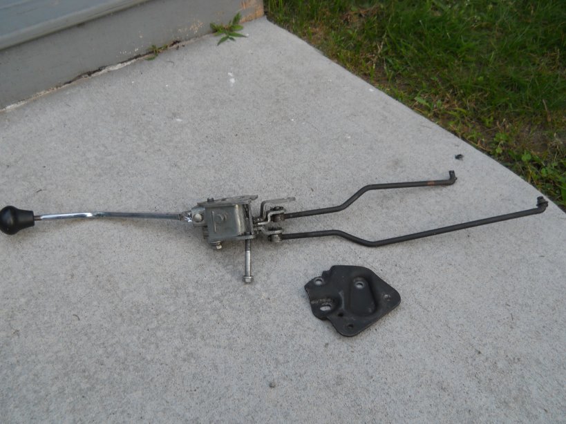

I solved the yoke problem now I need info for the shifter. I have a 86 c20 2wd with my6 (new process wOD) I am missing the reverse rod. Does anyone know the part number or have one? Thanks

I would just like to say you, sir are a lucky dude to have that trans! You may have to fabricate one from steel rod given the rarity of those transmissions.
47,210
9,482
Yep, might have to fab one, or get one from a Hurst Competition Plus Shifter, or buy a complete shifter. That'll be a tough find.

Yep, no longer available. I see you are in Michigan. If you need to see one in person I do have one that you can copy. It was a 3 year search to find a complete shifter so I am pretty protective of it. I live 75 miles from Benton Harbor in NW Indiana
47,210
9,482
Here's a post with some pics of it so you can get an idea what it looks like if that helps. BUT, I don't think these are oriented correctly. The idiot I bought the trans and shifter from had taken the shifter off and I don't think he put it back on right. There is another post on here here somewhere that I'm going to have to copy to make sure I have all the pieces in the right places. But you can see what the reverse rod looks like.

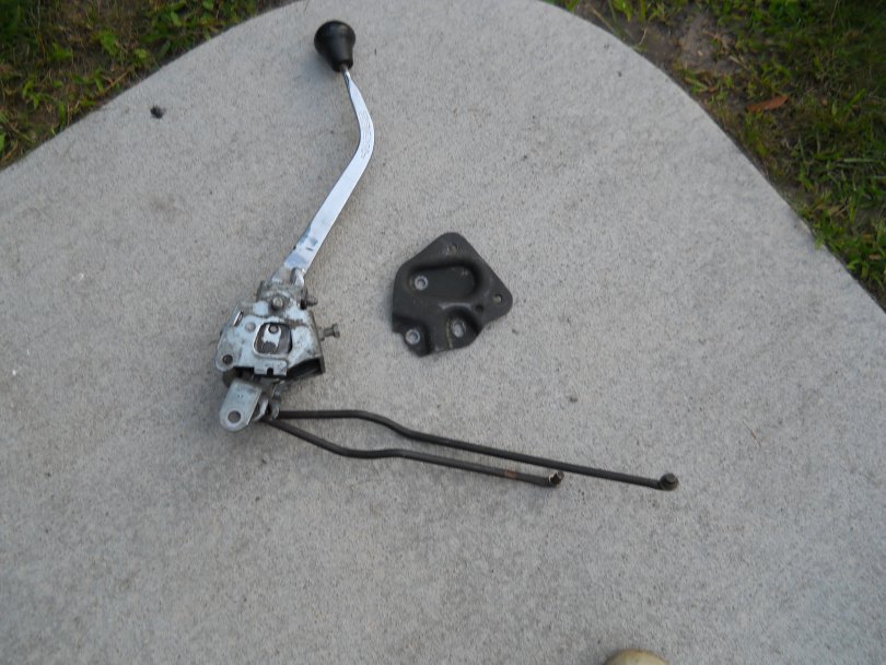

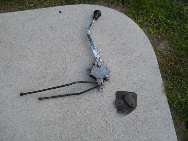

Thanks for reply. I am not sure the Hurst shifter is a direct match for the tranny. The provider said it was but the mounting plate seems a bit different from the photos I have seen. I am new to this site but I am going to try to post photos of my Hurst in hopes someone can ID it. It has no numbers other than part numbers stamped on the varrious pieces. As for the reverse rod it would be great if you could trace it somehow and send me a pattern and I could make one. Thanks

Thanks for photo. I posted photos of mine and I see the rods are reversed on mine thanks. First time for a project like this Thanks!

Now don't be going my photo in the link I posted. As said, I'm pretty sure the guy put that shifter back on wrong. I just posted that so you can see what the Rod geometery looked like so you'd have an idea of what the rod looked to know if you can build it or not.

Also, looking at your pics, your shifter does NOT appear the be the OEM GM Husrt shifter. I think that is an aftermarket Hurst Shifter. Notice the bolt with the adjustable stop on it. The OE shifters aren't even drilled for the bolt stops. Mine might be by the time I'm done with it. Also your shifter handle is not round into square like the GM OE sticks I've seen.
