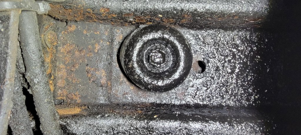

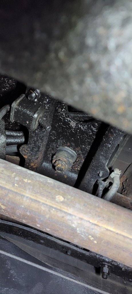

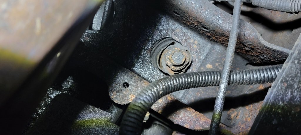

Thanks for all the input, guys! I went back out and measured from a consistent point on the frame that exists on both sides, and it turns out the axle is actually centered—very close measurement on both sides.
After clearing that up, I took a closer look at my cab mounts and noticed one was looking pretty rough. I decided to check the rest, and sure enough, one of them isn't even secured to the frame anymore—the lower rubber piece is completely gone. While digging into that, I found out there are alignment holes on the cab that are supposed to match up with the frame. Mine are off by at least a 1/4 inch in different directions, which got me thinking...
That misalignment might explain why the gap between my cab and bed is uneven—tight on one side, wider on the other but anyway. Now I’m wondering if that could also be what’s throwing off the front clip, making it measure like the axle is shifted compared to the body when i first measured when it’s really the cab that’s out of square.
My main questions now:
  • Could that cab shift cause a noticeable difference up front, like the 2-inch gap I saw when I thought the axle was off?
  • Is it possible to replace the cab mounts with the front clip still on? I’d really like to avoid tearing the whole front end off if I don’t have to.
  • Any other ideas or things I should check?
Appreciate any thoughts or tips—thanks again!
