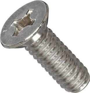

Mine were 1/4x20 screws that look like these with a tapered shoulder. There are female threaded inserts mounted in my roof.
That's how my '88 rack is mounted. There are nutserts in the roof, btw. The '89-'91 Burbs seem to have all got a different style rack than the previous years.
