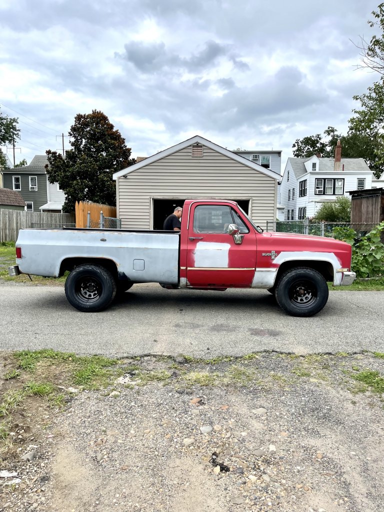

This truck is all original. The only thing I want to update or change for now is the ride height. Since it needs new shocks and an alignment, I want to get it to have the height of an R20 or 4x4. Maybe it just needs a front level kit? I guess I need to know what tires would be correct too.
Thanks.
I used one ton springs and 1 1/2 blocks in the rear. And im on 31s
