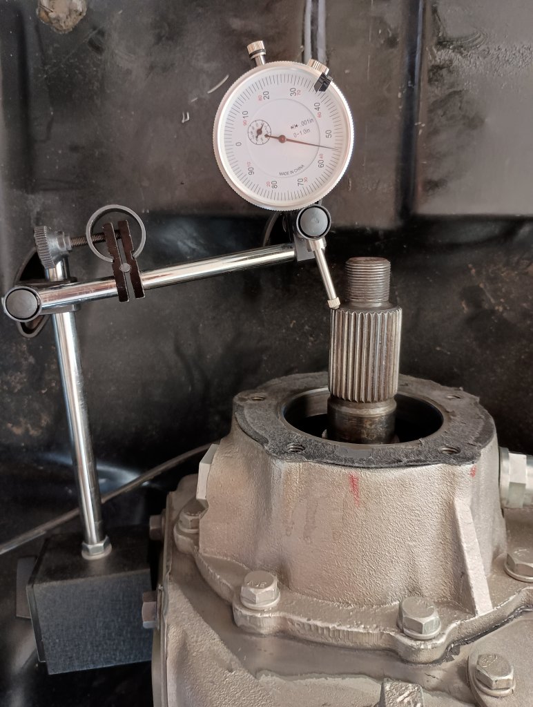

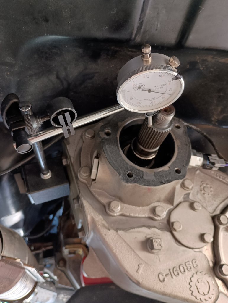

Tell me how to eliminate 155 thousandths of free play on the REAR output shaft.

Rotational or end play?

End play. These use ball bearings on the output shaft so there is no spec for thrust clearance. Without taking it apart again, I'm having a hard time visualizing where the gap is. New input shaft all bearings and case. Yes, I said new case.

You have to understand helical cut gears and how they create thrust. Shaft is going to walk back and forth in accordance with the gas pedal.

Not
Not possible. Bearing is retained by the c- clip on the bearing itself
You’re looking at a different bearing. There is a needle bearing assembly at the REAR END of the front output shaft that is pressed in to the rear cover.

Agree. But the FRONT OUTPUT shaft is not my issue. The REAR output shaft is. It appears the rear output shaft connects directly with the FRONT INPUT shaft. I edited the first post to specify REAR output. Sorry for the confusion. The photos should clarify that.
