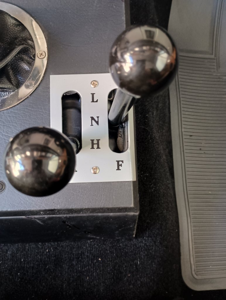

There are various kits on the market to essentially stack components of tcases in order to increase the ultimate low range ratio(s).
A “Doubler” (while often used generically for tcase combinations) specifically refers to a kit offered by Off Road Design that has an adapter to mount the range box portion of an np203 tcase in front of a complete np205 tcase, with a kit like this you can run the np205 in low range (1.96:1) or both the np203 (2:1) and the np205 in low range for a combined low range of basically 4:1. Greater low range ratios allow for more control, more mechanical advantage, etc.

Hello everyone. Hope your Thanksgiving goes well. This will be my first posting on this site. I'm currently working on my dream truck build...a 1991 V3500 Crew Cab Cheyenne 4x4. Found it 2 years ago on FB marketplace and couldn't walk away from it. It's in rough shape, and it will be built from the frame up.
Anyway...as the title of this post suggests, I've been researching a way to remotely control a NP203/205 doubler. I honestly don't want to use air shift solenoids for the mechanism. In my search through the net, i possible have found a way to add a particular set of t.case shift motors and the control system for it. The parts for the system have already been made by one oem company. I've started to gather the parts to test the idea. But I'd like to get everyone opinion on the control panel for it. Here's a render pic of the Mark 1 Control panel for the system...
I'm going to go against the grain here, but I think if you have the ability and the know-how to get it done, then go for it. Worst case, it's a failed experiment and you simply run the tried and true shifters.

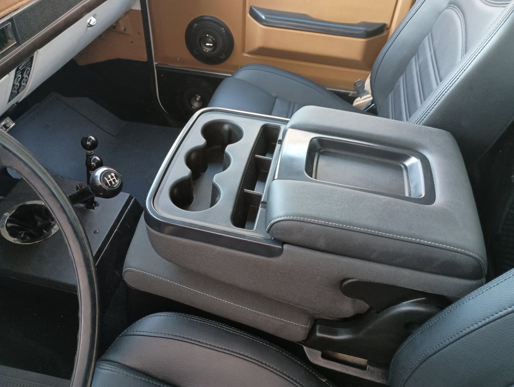

that's funny cos I am building a doubler for our 4x4 trail rig. The fact that it has an extra 2 levers is a plus. Its also a manual, and hope to have a level engaged pto. / winch, front and rear that would make for at least 6 sticks. figured that would be a good theft deterrent ...
however its your rig, so go for it.
