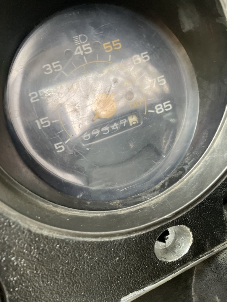

Will my Speedo still work if the needle was broken In half, I can’t drive it right now so I can’t figure it out

It'll work. It'll just be harder to read the speed. Mine broke on the first test drive after installing the new heads. Cruising down the freeway, speed good, then checked the other gauges and when I looked back at the speedometer the needle was gone, just the center portion remained. Now I project an imaginary line from the center portion to what seems be pointing at. Eventually I'll fix it, but not until I need to get into the dash.

Yeah… it was a pain in the ass for me to put the gauge cluster back together and to finally realize the needle broke when it’s all finished lol

It actually quite easy to replace. White housing stays in. Remove the bezel, lense, shield and screws holding the gauge. Reach under around back and unclip the cable, pull spedo out. Only tools required are a Phillips screwdriver and a nut driver.
