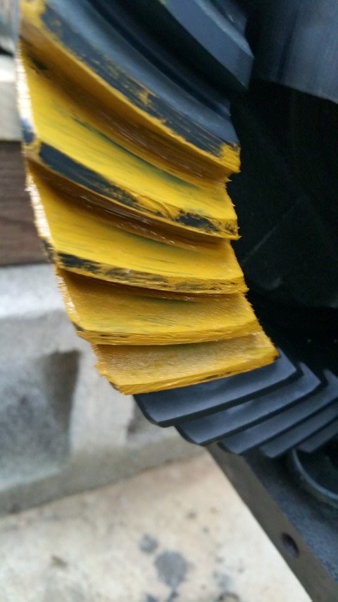

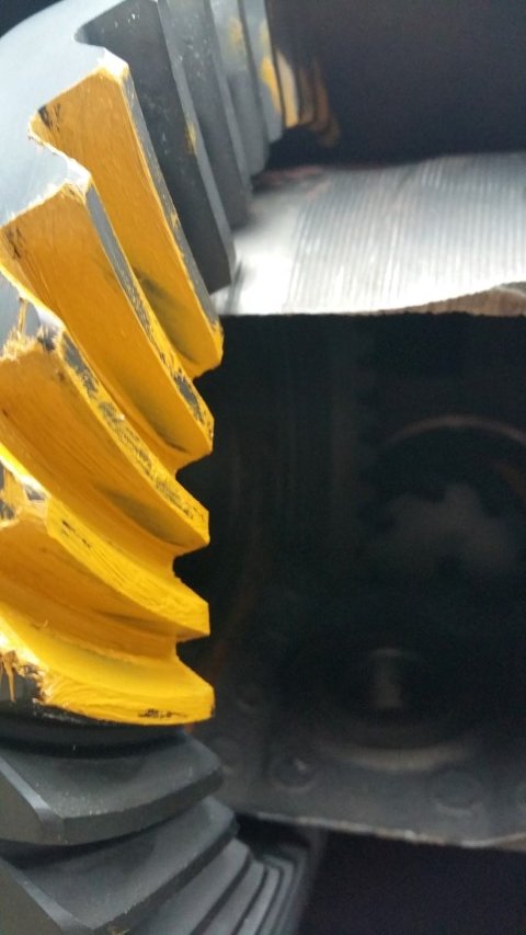

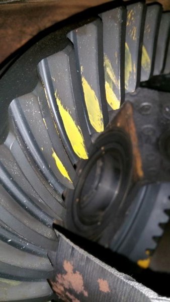

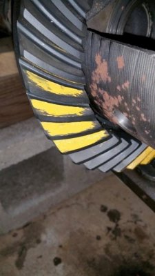

New to setting up gears. This is a GM 14 bolt semi float, re-gearing from 4.10 to 4.88's. This is the first try with the new set up in the differential using some "set up" bearings on the pinion with original pinion and ring gear shims. In an attempt to keep from pulling the unit out a dozen times in pursuit of perfection, I thought I'd ask for some advice here based on my pics. 2 pics of the painted ring gear teeth and 2 pics of the painted pinion teeth marking the ring gear.
