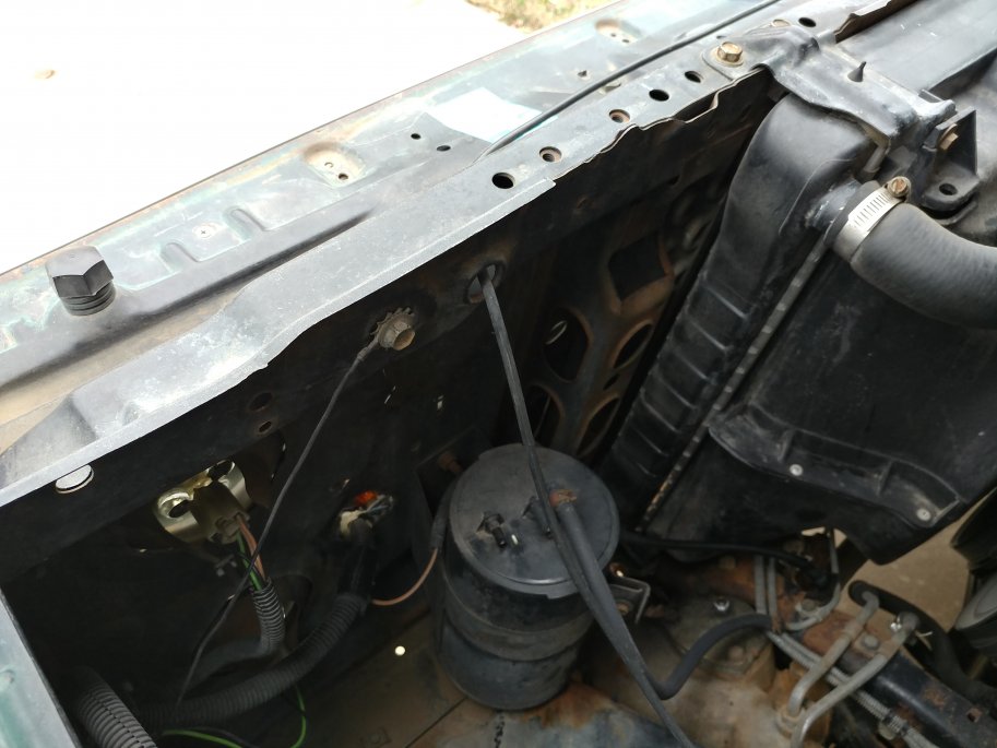

Rusty Nail
Jan 29, 2015
10,097
10,240
Rusty
350sbc
It's actually VERY important. It may (or may not) run behind the battery and may (or may not) fall victim to that type of corrosion.
Either way, it's best to keep a mindful eye on it.
It has been my experience that many "auxiliary" systems rely upon it.
Very likely comes out of the headlight harness from the core fupport and I THINK, should run directly to FRAME underneath the alternator.
Like I said, it's kind of a big deal.

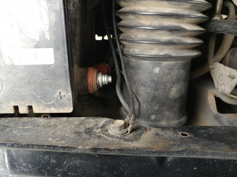

First pic is driver's side and second pic is the passenger side.
4,564
3,819
I noticed that while changing the connectors on mine. I thought, bah, I don't need that ground. BS....you do need it lol. The only ground I noticed though was on the passenger side.
Yeah, grounds are vital for electronics to work correctly. I suggest finding the ground wire on driver's side and getting it grounded.
74 Shortbed
Aug 12, 2013
6,306
1,413
Make sure ALL grounds are in good shape..
