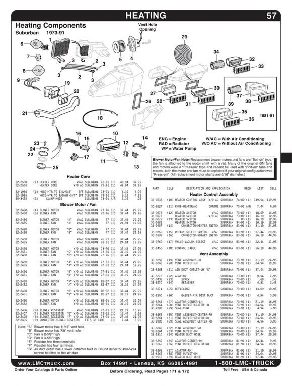

Here is a page from LMC. Looking at this, I can remove the vent ducts and block off the holes. Leave the vent's in hte dash for cosmetic look. and re-seal some of the connections on thouse housing pieces.
Heater core looks fairly affordable, I will shop around for a new one to install.
However no vacuum hose assembly or harness seems avail here. Might have to check the dealers?

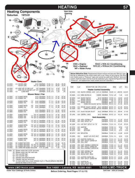

****, heater core mouints on the outside under the hood, right? Maybe I will shelve that idea until the inside is done.
25,701
9,740
Red is what I will remove and blue is what I will block off. I don;t see anything here for the defrost and floor heat ducts. :think:
