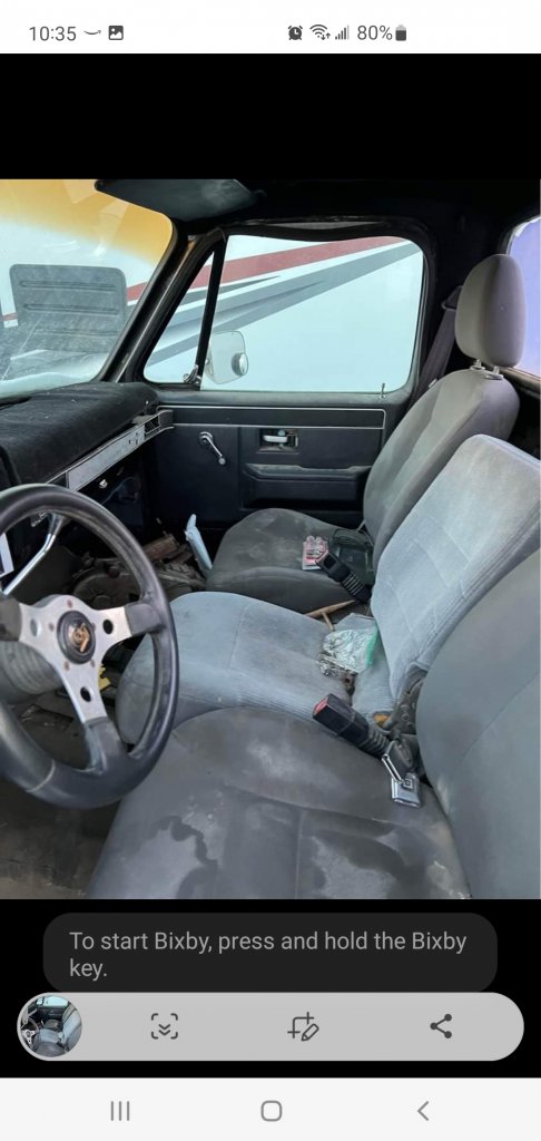

Now I don't feel as bad about having furd seats in my k10, but mine are buckets from an escape with a 90s truck center fold down. And yes I know the seats look nasty, they were junkyard seats I put in before selling the truck and just bought I back after selling it years ago.
