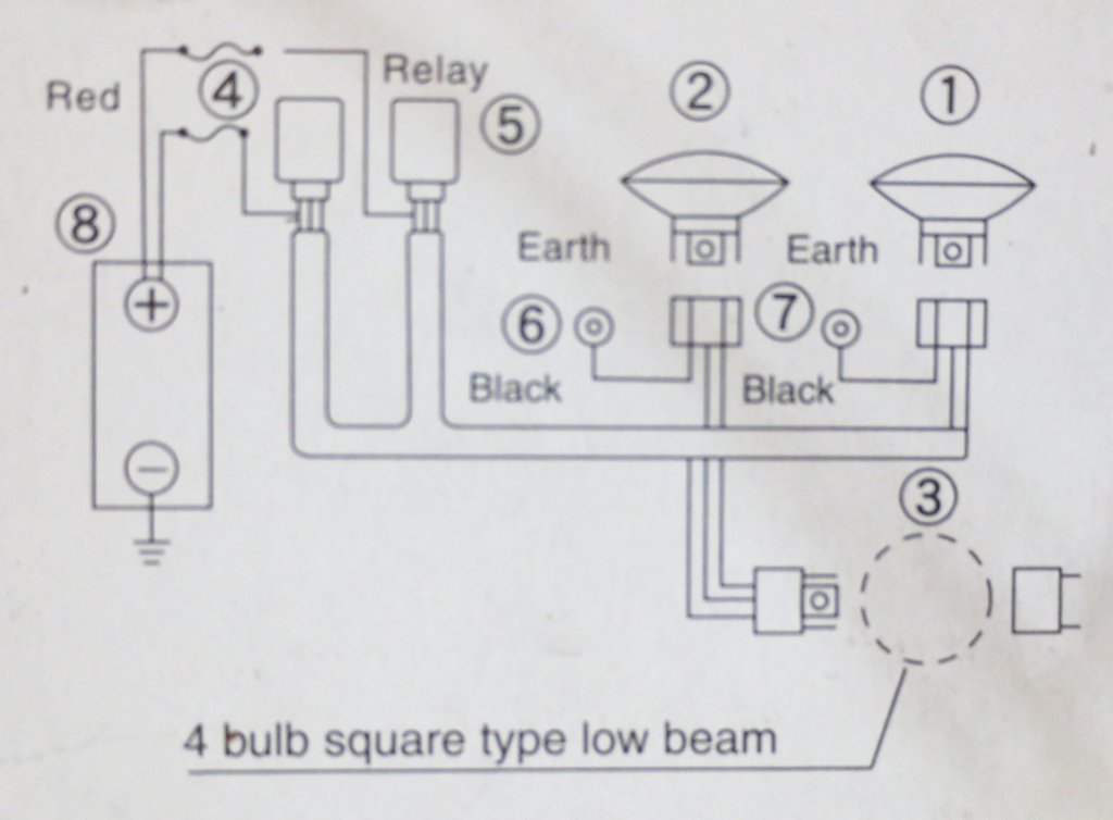

Well, I made a mistake, not really, I purchased a 7 inch headlight kit from Toyota it comes with the relay kit which is really well built. The mistake I made is ordering 2 why I don't know. If someone on here who has a round eye is looking for a upgrade. $45.00 that covers the shipping to whom ever pm's me first!
