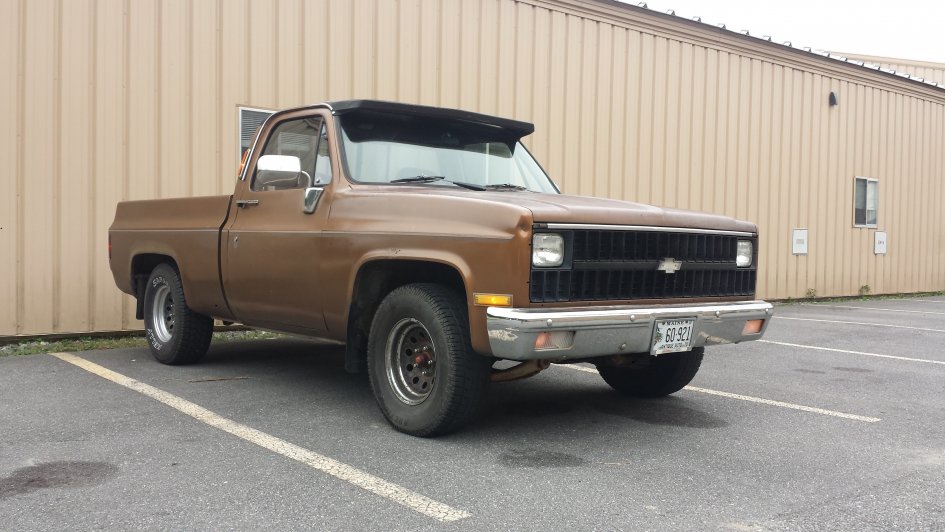

I'm kind of partial to the unique look myself...
