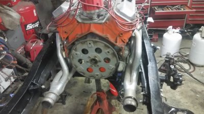

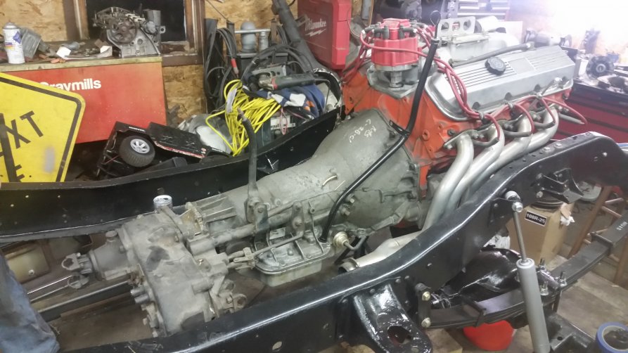

I have Chevelle headers on my bb in my v10. They stay above the frame.....above the trans cross member for that matter.

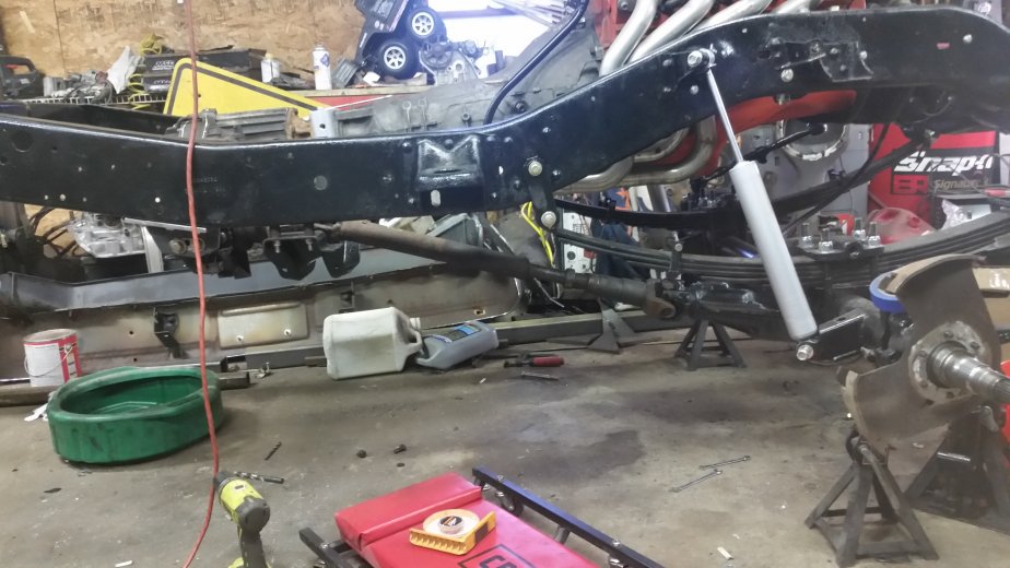

A few more shots

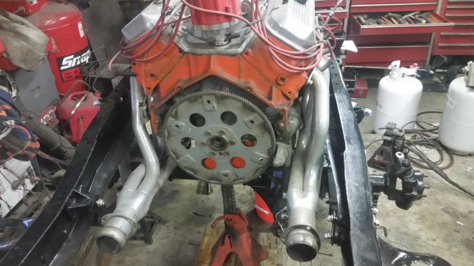

I've got headers that came with my BB Nova, fit great and tuck up in the frame. Probably the same as Chevelle headers.

They were in my 67. Chevelle,68-74 Nova and 1st gen Camaro is what they were listed to fit.
This is what they were in. My previous project. Sold and down the road drive line less. Dont mind the rims i did an s10 rear disc swap and thats what i had laying around that were 16s.

I did have to notch the frame a little on the driver side for the front tube. Other the that they fit. My engine sits pretty low in the frame. I usex car solid mounts and had to notch the cross member to clear the oil pan which is also a car pan. Not 100% sure what kind of interference you will get with upper control arms.

Mine are Hedman.
