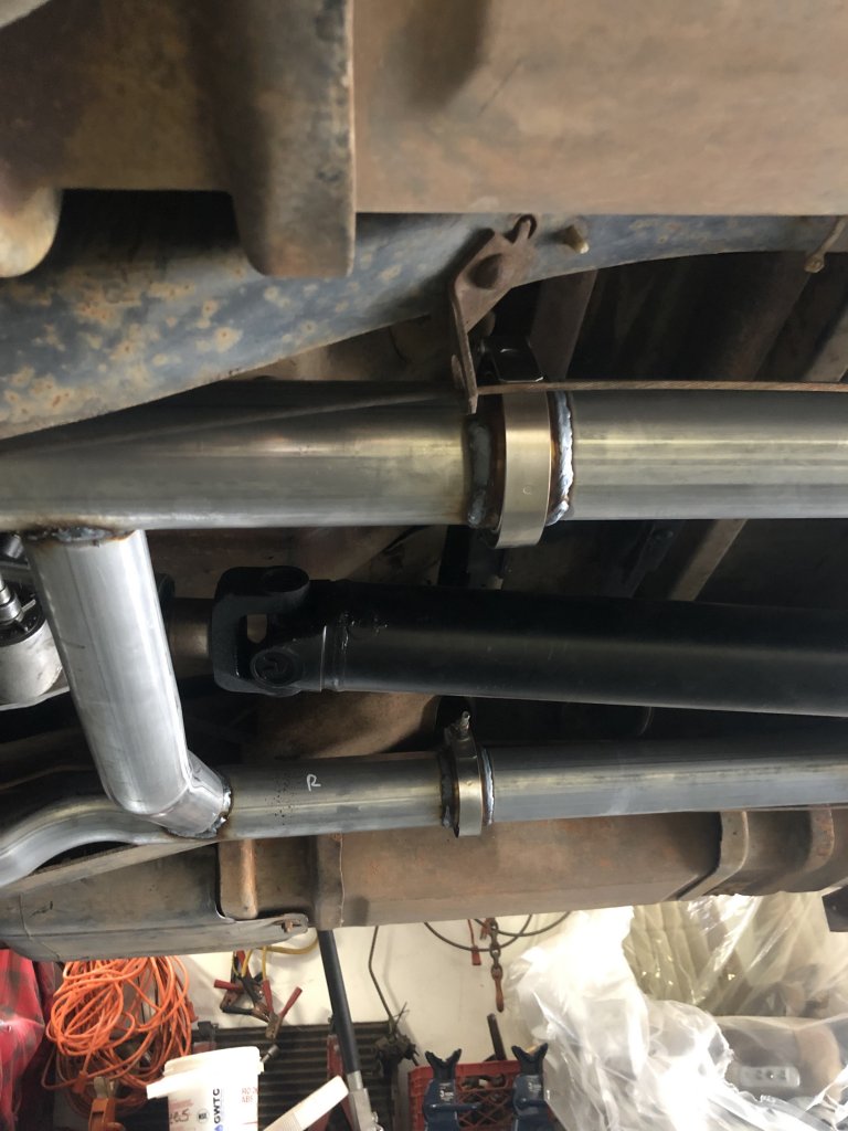

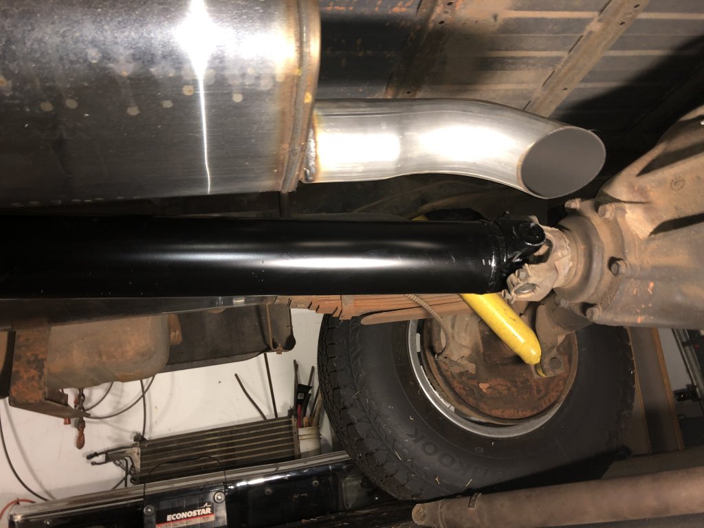

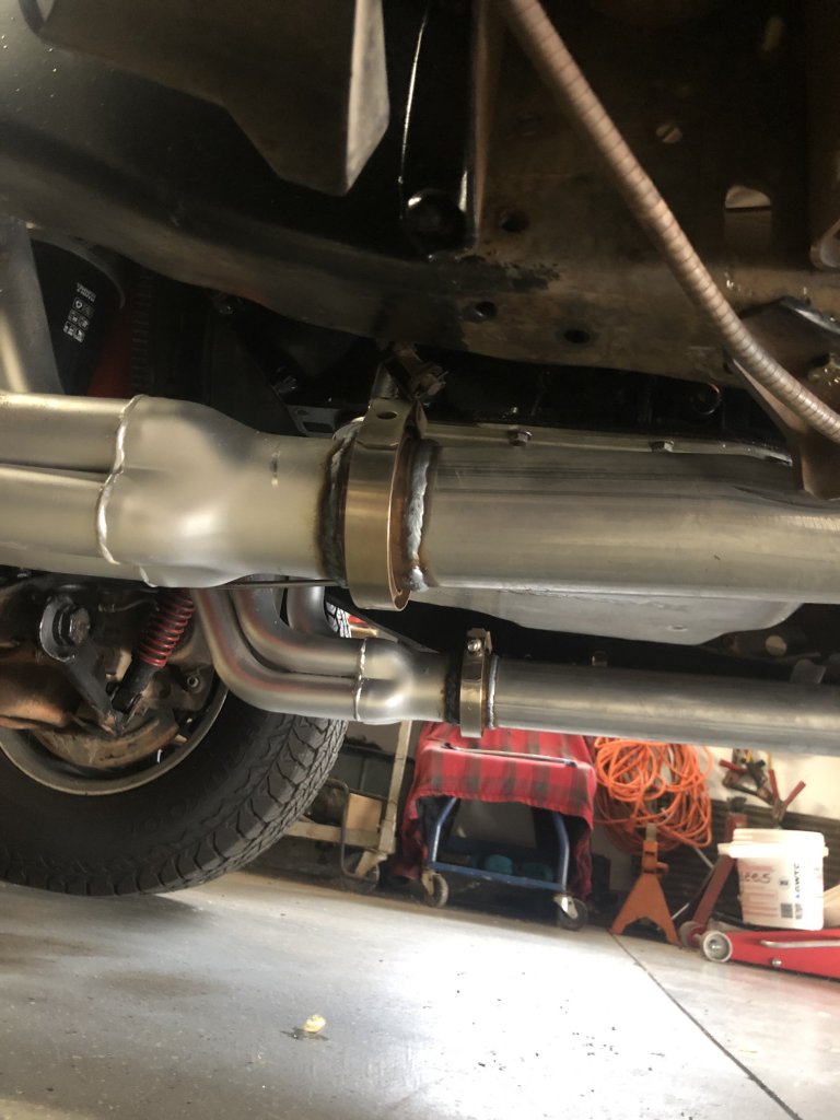

Mine was all done at muffler shop, cut the stock collector flanges off & installed v-band clamps with a 2nd set of clamps behind the crossover pipe, all 3” with magnaflow mufflers dumped off. Headers are Hedman extreme duty 14ga with 3/8 flanges thermal coated, tailpipes will be added in the spring once I decide what I want. 82 C20 454 that’s been worked over pretty good, sounds great!
