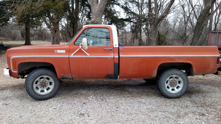

Here ya go

how did they fit over the rear hub on the 14 bolt?
Boonie
Jun 3, 2013
287
134
El Dorado, KS
Brent
they fit on the rear just fine. this is actually the third truck they have been on. I had them on a 94 GMC 2500, and an 08 GMC 2500. They actually go on the 08, just on here as a loan until I get my new wheels powdercoated and new tires on them.

so just need to sand them a little bit for the front then
Boonie
Jun 3, 2013
287
134
El Dorado, KS
Brent
yea. kind of depends on what front axle you are using too I think. I think they may fit on a 10 bolt easier than mine, but I don't know for sure. just a theory
