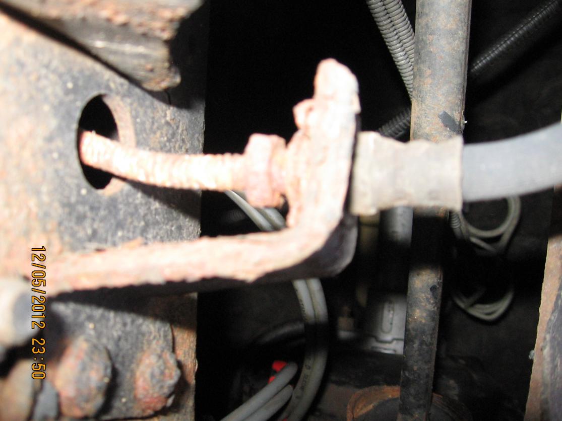

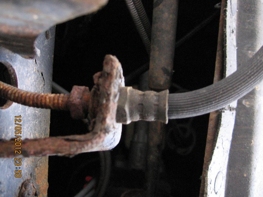

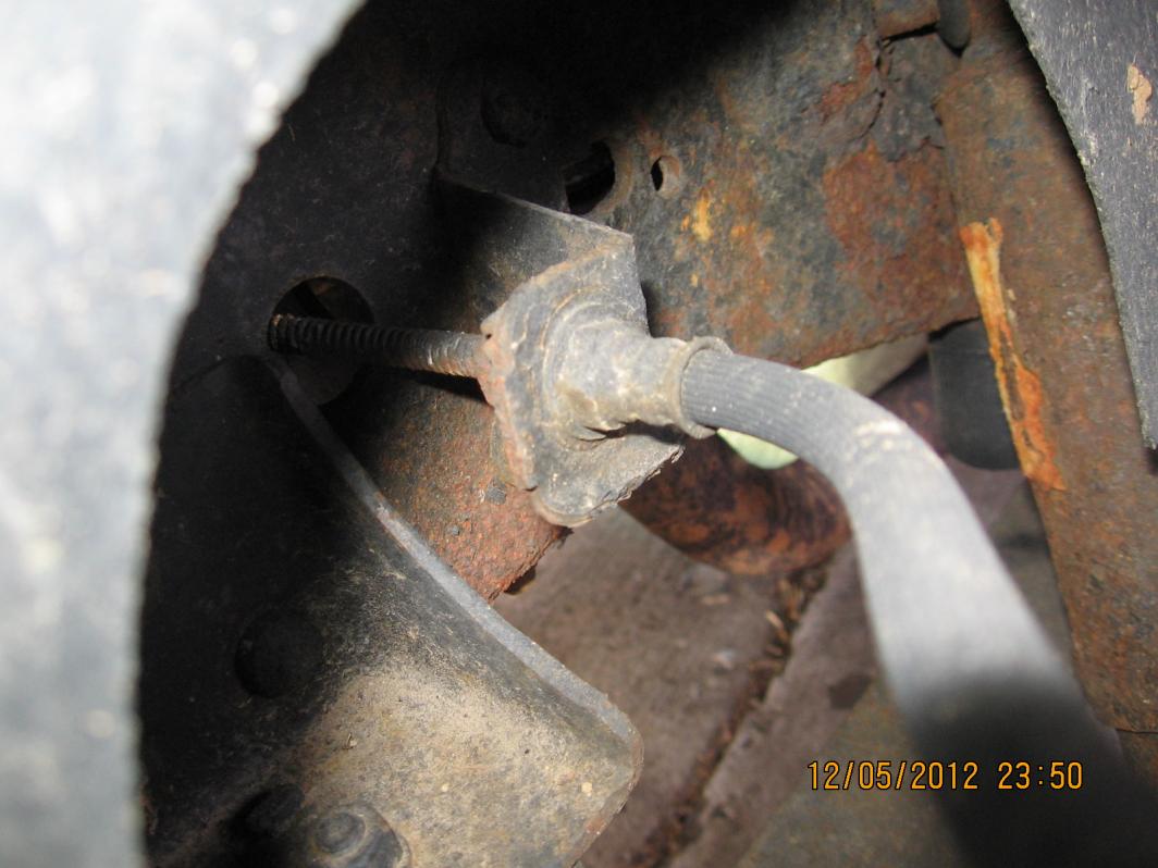

Here is some reference pics for the front 4WD brake line frame mount area someone asked me for, sorry for the ****** rust making the pictures bad. My poor cancered Burb, I am so f'd if I have to work on these brake lines.... :( :(
