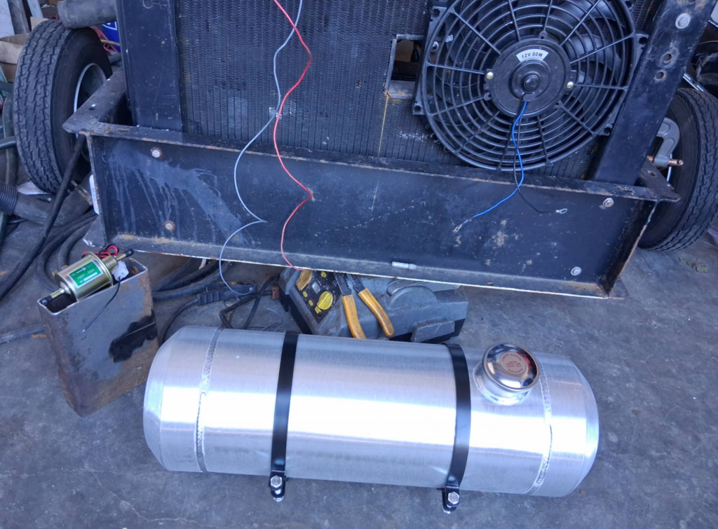

Run stand is going together ...
Trying to low-ball the build ..
Used parts from a boneyard helps, but some items are bought new ..
Acquired a panel from God only knows what ... ( Junkyard stuff )
Tach hole is the right size. but not the oil/temp holes ..
Doesn't look like there's room to make em larger to fit the Auto Meter gauges ..
Another item that's new has been ordered ..
blob:https://www.facebook.com/417dcb3e-e604-45c6-80ce-f2e3235d7aa1
Fuel tank is next to mount up ..
