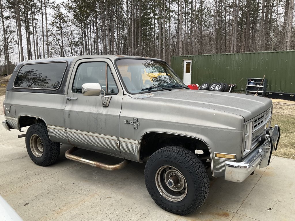

i have a 86 k5, years ago when it was my daily driver i never had issues filling up the tank, now its back on the road after several years and when i fill it up it will only fill up about 3/4 of the tank before the nozzle shuts off, if i have the gas filling at full blast it will shut off a little after a half tank, i can hear it gurgling and if i wait a little bit i can get more gas in if i just barely pull the trigger then it will fill all the way to the gas cap and when i stop i can hear it gurgling again and it will slowly go down, if i do this over and over i can get it pretty much full but it takes forever, i pulled the rubber line off the vent line and as far as i can tell it doesn't seem to be plugged, anyone have any ideas what the issue may be?
