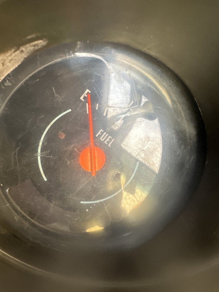

Anyone know why a gas gauge would peg at E when turning the key?

Positive wire from sending unit top terminal to fuel gauge is grounded. If you pull the positive wire off the top terminal the gauge should read way past full.
Shucks I would have to drop the tank right?

I would check the wiring from the tank up to the gauge first.
