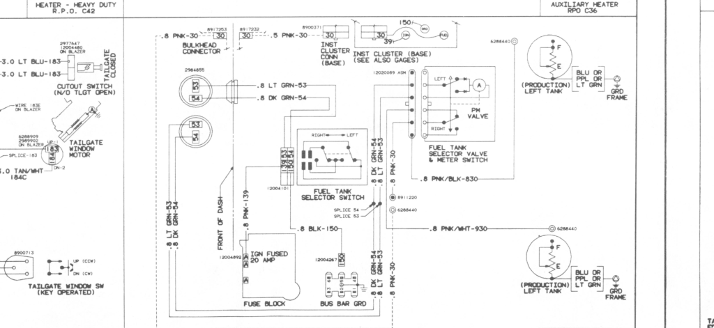

I think this is for an 82’ but bottom line. “Pink is Power” here.
