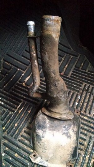

Here is a picture of my existing fuel filler neck. Can anyone identify the year? It does use a 1 3/8" hose.

When I redid my tanks from my 79 i got new hoses from LMC truck. They where OEM replacements and fit perfectly.

The fuel door opening is a 79'-83' style. I have both styles and it looks to me like the later 84-87 would retro but Im not sure as I have not actually tried it. But your fuel fill opening is definitely 79'-83'. In 84' it changed from the partial metal splash shield to a plastic splash shield that encased the entire opening.
