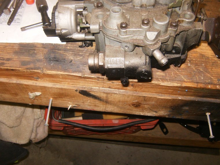

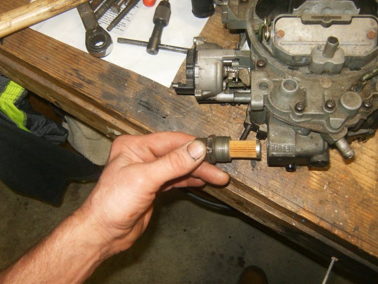

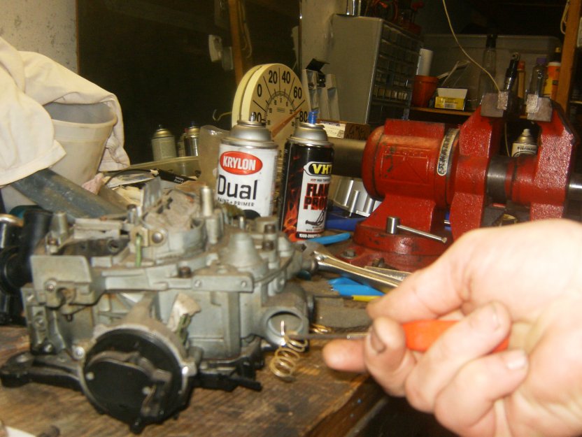

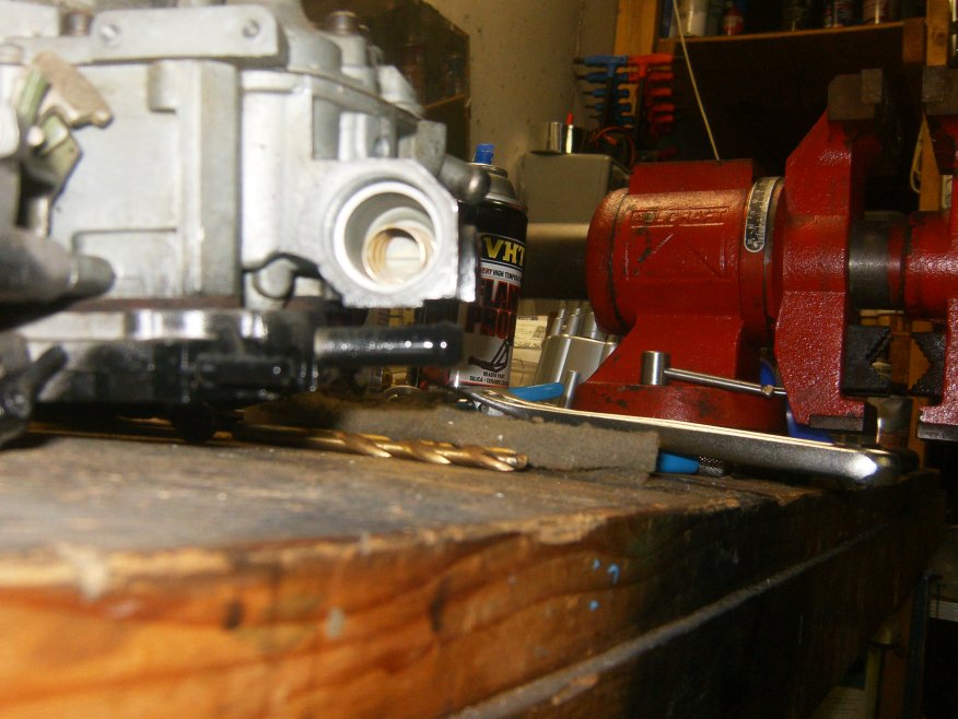

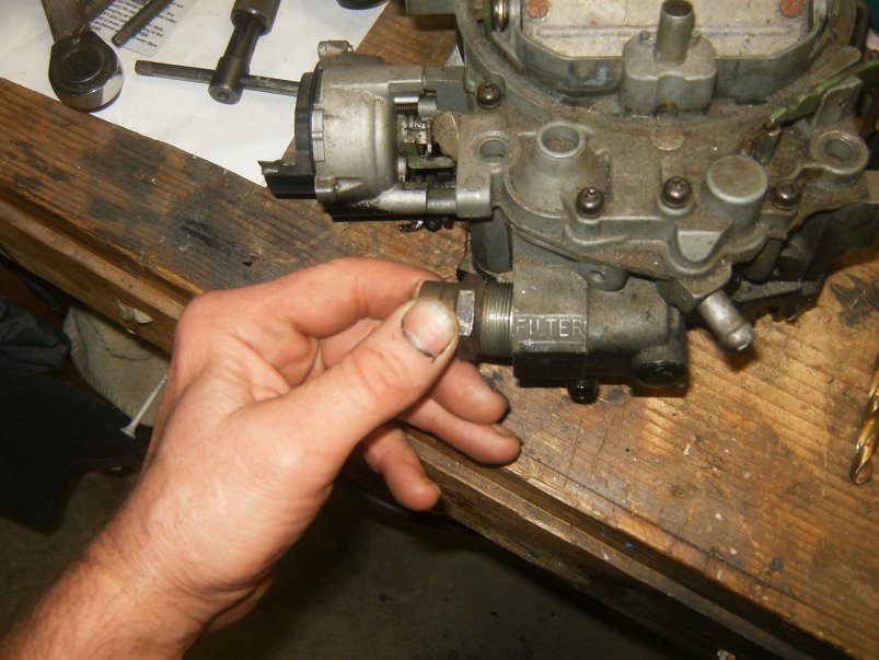

Q-jet still installed? If so, pull the inlet tubing off the carb where it threads onto the bowl inlet - where it says "filter" on the outer casing - and change the gas filter. See below.
A carbureted engine that runs fine - until high fuel flow is required (i.e highway speeds) -is a textbook case of a fouled fuel filter. It can even run well under heavy load for short periods due to the reserve fuel in the bowl. But once that is used up - you only get what the filter can pass.
The next step (if the filter is okay) would be to check the fuel pump capacity and the condition of the lines.
Here - you know what; 2 birds with one stone. While the gas line is disco'd - put the open end in a container. Have someone crank the engine while you direct the stream of gas into the jar/bottle. Crank for 15 seconds.
If you get a pint or more of gas in the bottle your fuel pump is delivering plenty of gas to the carburetor.
Fuel flow through the pump and filter are okay? Need to check the bowl float settings and the float for integrity.
If you have a TBI engine disregard everything I just said and we'll start over.
There is a chamber behind that adapter. Pull the adapter and you'll see the filter. There is a spring in the bottom of the bore that seats the filter frimly against it's gasket - don't lose it.
