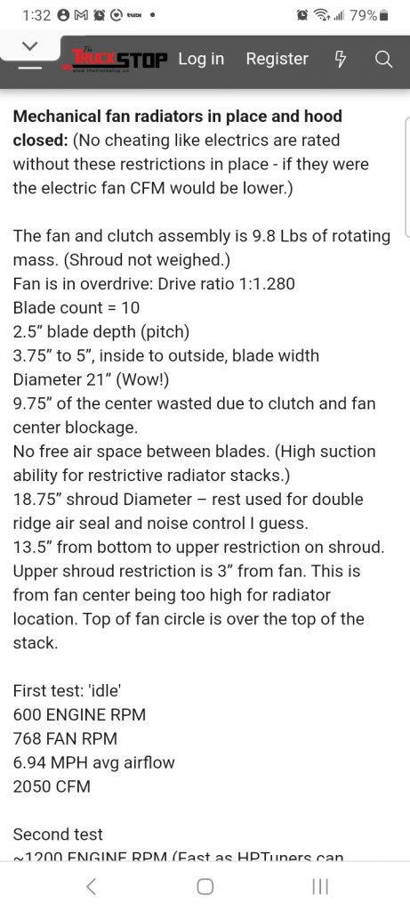

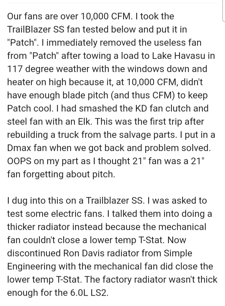

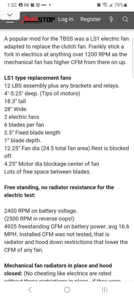

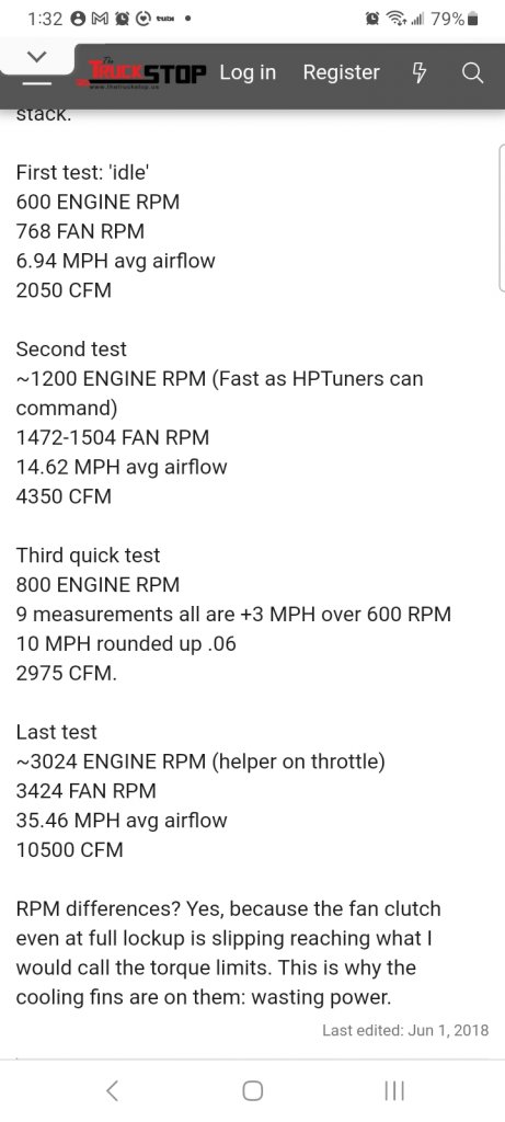

Most electric fans cannot move as much air as an engine driven fan,most aren't even close. If an electric fan is against the radiator no fan shroud is needed the shroud then actually blocks air flow through the radiator,unless you add flaps that open at road speed. Aluminum also does not conduct heat as well as copper,the advantage aluminum has is the ability to run more tubes,for more surface area and a good one probably does, but a cheap aluminum radiator will not work as well as an O.E. copper radiator.
