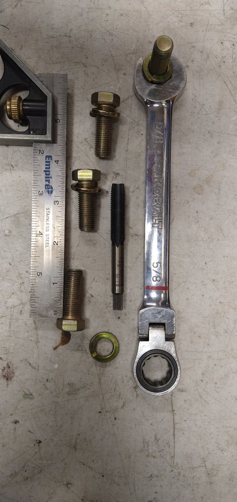

First off, Bucket and I were both wrong. The correct bolts are 7/16-20 (fine thread), 1-1/4 long and a 5/8 head. Sorry, carry on. My shaft is at the drive line shop getting shortened and rebuilt. These are the correct bolts.

Interesting. I'm still fairly certain that the ones I've had were course thread.
But yeah, 7/16" bolt size, not head size. Head size of any bolt can vary with different manufacturers. For some reason, the 7/16" size seems to be the most inconsistent.
31,892
32,688
Yep, all my 205's and 208's use a course thread bolt. It looks like my 203's do as well, but I didn't pull a bolt to confirm.

Interesting,They must have changed pitch at some point. Mines an 85, OE and definitely fine thread. I guess if I were the OP I would just buy both. It's not like it's gonna break the bank.

I'm thinking it must have depended on the supplier for different plants? My 88's original was course thread. The replacement was as well, but I don't recall what year it was made.
