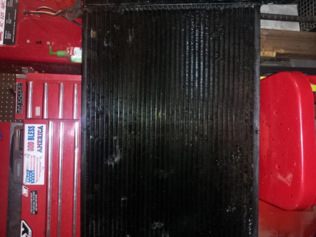

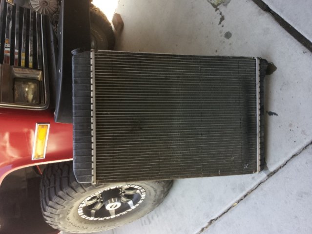

Is the four core really better at cooling then a aluminum one . Ive got a copper brass one from my bro hes not using two of the fins are closed off and has other damage thats been sealed with soder. Dosent leak so far I capped the Iinlets and filled it with water pumped some air in there didnt leak. The aluminum one I have will start to overheat if im sitting in a lot with motor running..

Well ill swap it in see if it makes a difference. its not to hard plus will fit better. Ill make the fans fit right before I put it in so I dont have to take it out again to fit it. Then when I get the controller the instsll will go faster...

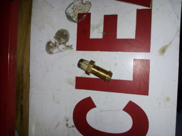

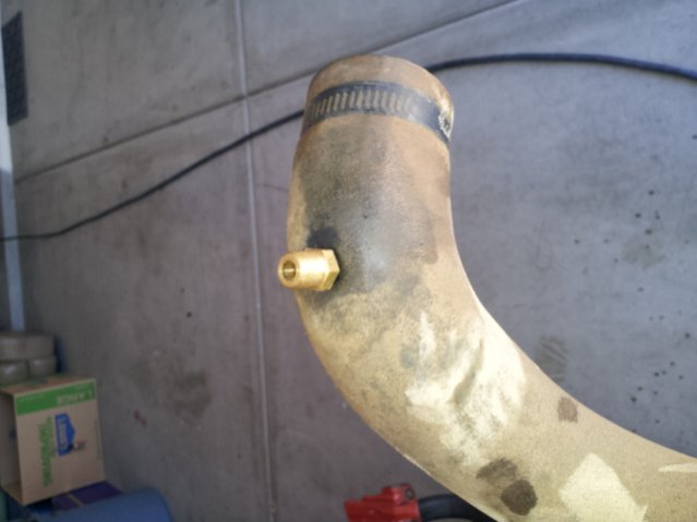

I had time today so I pulled the aluminum rad out for the copper brass four core. Bought a new lower hose aswell just because its probly time for one. Changed it out and no leaks anywhere so thats good. Took it out for test drive it looks to be running 1/8 cooler on the gauge wont be able to lazer temp it till monday..sprayed off old aluminum one and crap it was full of mud..that may have had an influence on cooling properly..I reused the coolent it was prety new... this is how I got it out I poked a whole in lower hose and put a hose barb in it shot right into a clean bucket no big mess. I thought it wrked great

Old aluminum one and copper one.. the copper one fits right where the mounts are nicely the aluminum one sat on top of one side.. and no big gaps on the sides of the shroud.
