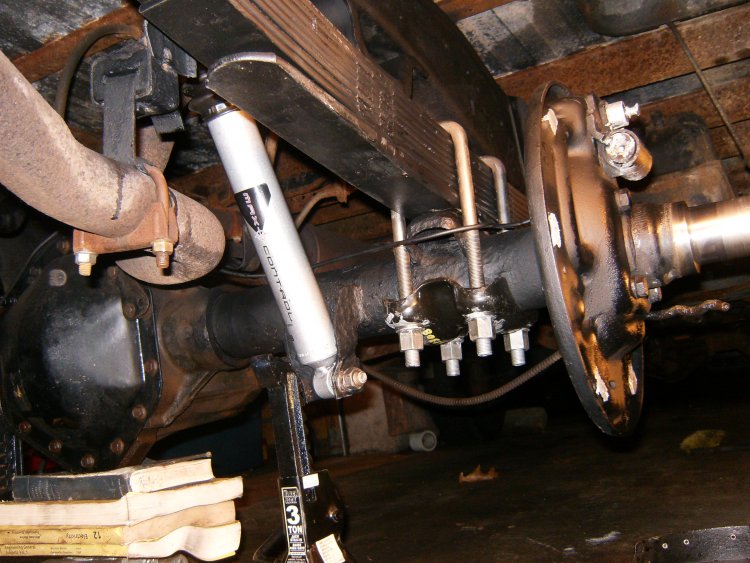

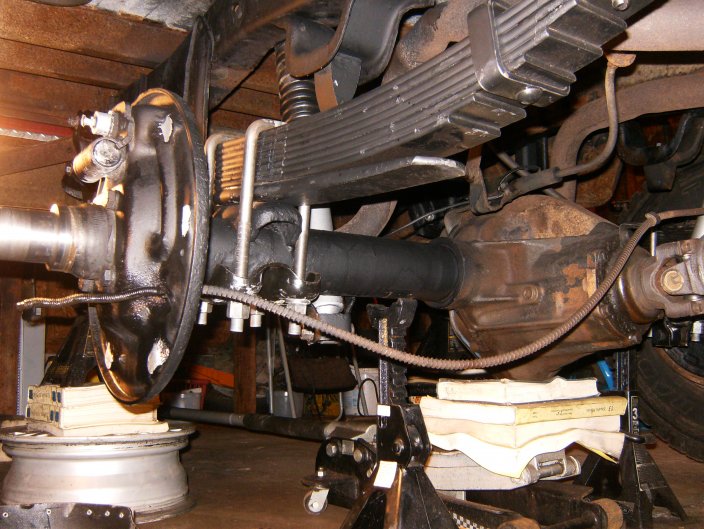

Donovan Spring in Londonderry NH bailed me out. The truck is a K35 single, with a 14 bolt (10.5").
The U-bolts are installed upside down and run opposite the normal direction. I was having a wicked hard time sourcing these. Donovan had them on the shelf. I bought them along with with new 9 stacks (shackles, bushings, hangers) so I really don't recall the cost but I would be surprised if they were more than $10 -15 each.
These guys are good - they only do truck springs.
http://www.donovanspring.com/Donovan_Spring_Parts.html
Or you could hunt around Nalleys data base. They look like all U-bolts cost $10.66.
http://parts.nalleygmc.com/productS...e=0&isAccessory=0&isPerformance=0&searchTerm=
