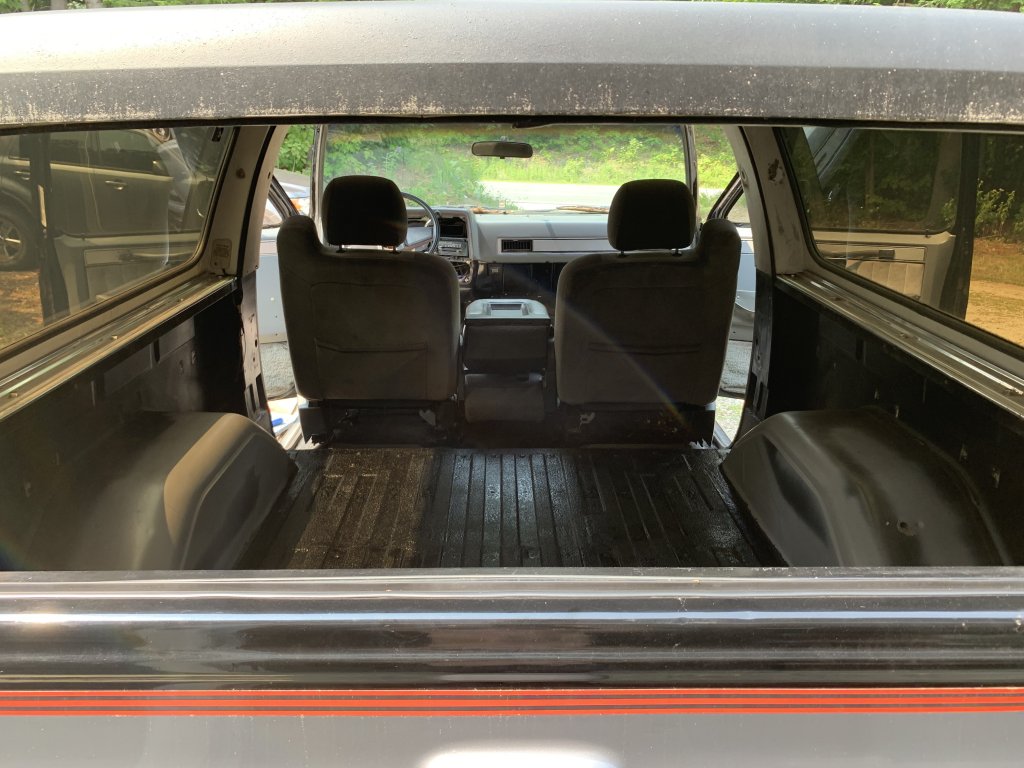

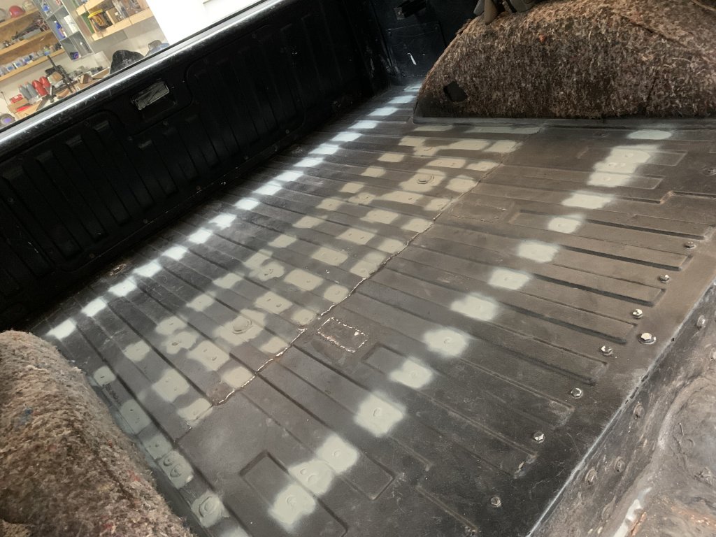

Well I finally got around to doing some body work. Busted most of the bolts out a and replaced the uni strut with solid channel and used the existing holes to plug weld everything up. I still have 2 body bolts by the tailgate I need to replace with carriage bolts but the forward two are done. The bed was lined with some rubber crap which has been a pain to work with. The PO’s welding was passable and I cleaned it up lightly with a flap disc. Thinking of trying the raptor liner product when Im all done with the floor work. That step up behind the front seats still has bolts and I may have to leave all or most of them, not sure yet but thought I would at least provide an update as of now. OEM pics would help tremendously!! Not sure I can plug weld these without a backer so therefore I am not sure it’s worth the trouble but I am open to ideas! Rockers are in as well and the parts from AMD fit great. The front floor patches are still left to do but should hopefully be done soon

TotallyHucked, you dont happen to know what the underneath of the back floor (bed) and the step-up from the front floors is supposed to look like?
For more context, my rear floor looks like its been replaced but is loaded with bolts. The step-up is as well. Underneath the rear floor is cross braced with a couple rows of uni strut, not really a terrible idea i suppose. The strut is bolted to the floor all the way across. Just wondering what is supposed to be there, if anything. Added a few pics for reference. Not that I am looking for original but Im a decent welder and might be able to do a little better than the last guy…

Thanks grit dog. Everything is nice and solid. The solid struts I used are 14 gauge and take place of the thin factory hat channel. The bed panel actually appears to be newer so no need to replace that. Unfortunately the truck was rougher than it appeared and it has been patched up before but somebody did a halfway decent job at least (mostly thick plate), why he used bolts on the back half I am not sure but that is mostly taken care of now. These unfortunately were hidden by old nasty carpet and I didnt catch it. All the body mounts appear to be newer which is nice. Im gonna have to be creative with this one as money is tight. I am not looking to undertake a restoration, this will be a worker and I plan on using the bed at times when needed. I think the raptor liner (if anyone has tried this let me know - doing the best I can to remove all this rubberized stuff) will make the interior floor look decent enough when the welding is done.

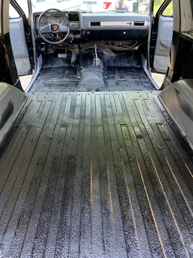

So i decided to use a roll on bedliner just to give everything a uniform appearance and also I did some heavy patching up front, floors, rockers etc and cleaned up some of the PO’s work as well and the textured bedliner just helped hide the seams and blend everything in without making a mountain out of a mole hill. Just thought Id share. A little glossier than Id like but overall I think it was a good choice.
