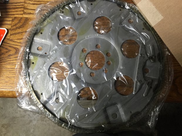

This should the engine side correct

Yes, weight goes towards the block.

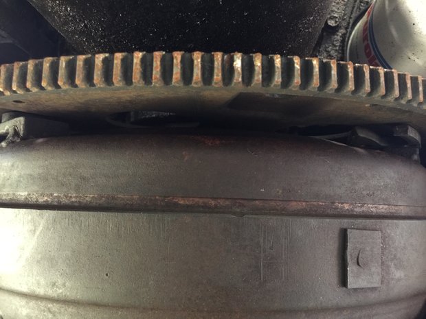

Ok just making sure I figured that was the correct way after looking at two other trucks but unfortunately someone put it on backwards on my 89 and I got this new flexplate Yesterday to replace it with. Here's my 89 with the weight towards the torque converter

That is not good.

I'm not sure who did it I just got it about two weeks ago and just started looking at it
