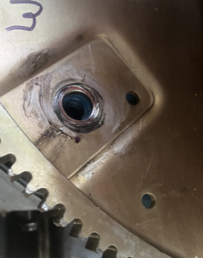

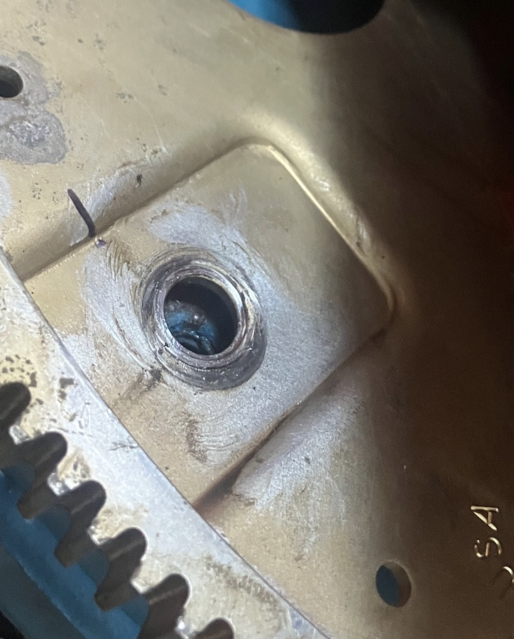

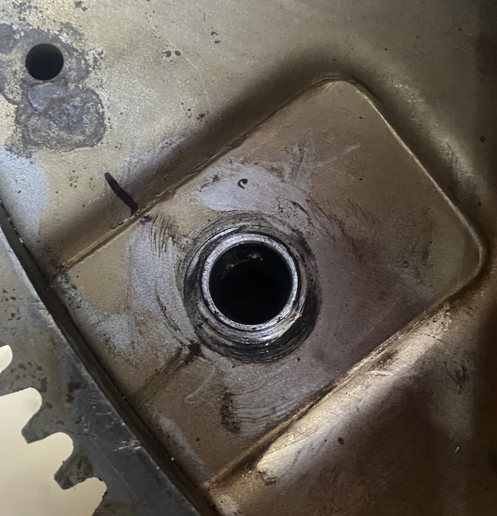

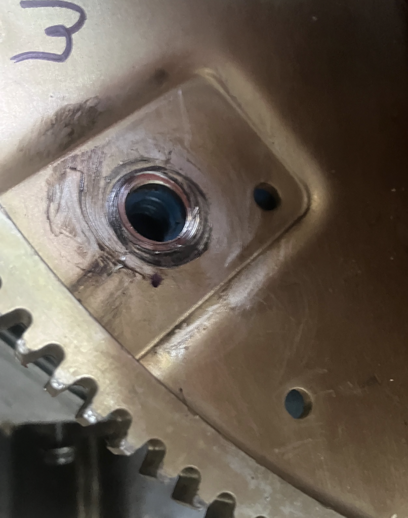

I installed my 350 engine with a th350 trans into my 73 C30 last weekend. Then engine and tranny are from another truck. I couldn't find many of the torque specs in may Haynes manual and google came up with a bunch of different answers. For the the torque convertor to flex plate bolts I thought I finally found the right torque - google said 75 ft lbs. Seemed high for 3/8" bolts but there's a lot of forced there so maybe it wasn't crazy. I could not get the torque wrench to click and having broken so many bolts in my life I didn't force it - it was clear something was wrong.
I finally found the right torque - 35 ft lbs - so I took the bolts off, replaced them and also tried to rotate the torque convert by 60 degrees to use the other set of welded on nuts. But it looks like I may have damaged the flex plate. I think it will be ok but wanted to get some opinions from folks that know better than to try to torque small nuts to 75 ft lbs.
Pictures attached.

Not ideal, but not bad. Bolt it up. Should be fine. I would use some sort of medium strength lock-tite / threadlocker / etc.
